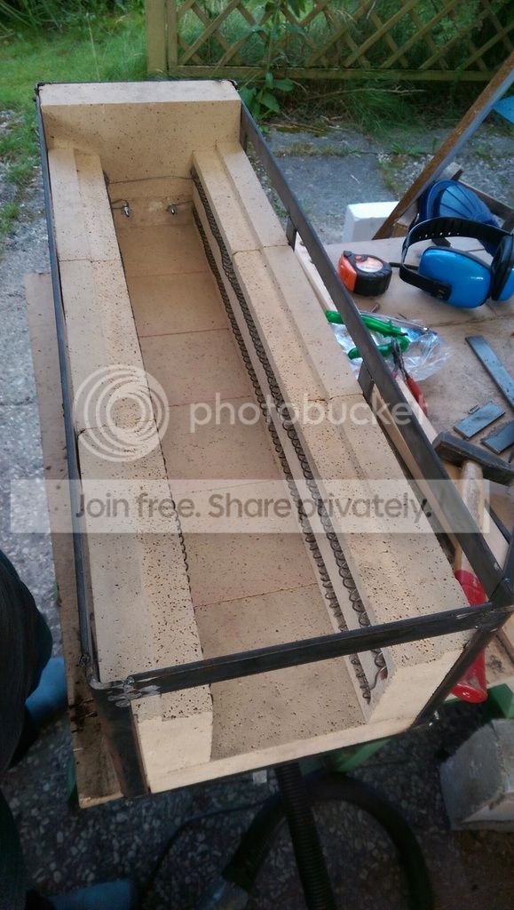

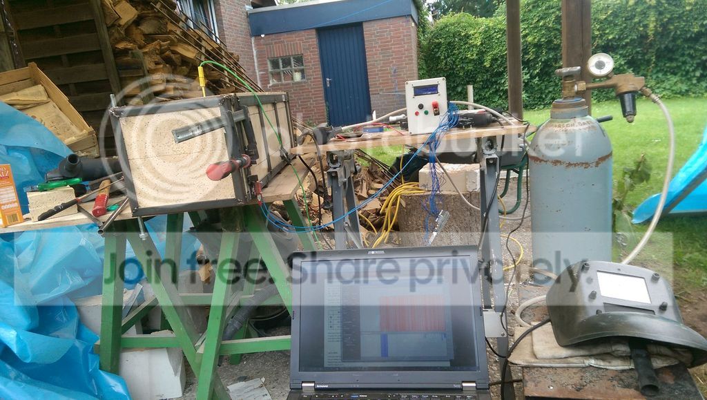

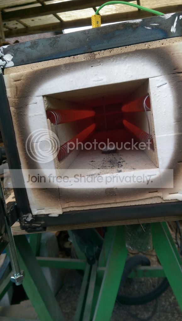

Now to my problem. I built a heat treat oven out of "Schuba FLS L4S" Stones, the Datasheet is linked here http://www.schuba-shop.com/WebRoot/...06-100640104_FF-FL-Stein_L4S_250x124x64mm.pdf .
To give you a view of my oven, i've attached two pictures.
(On the right, there is a contact switch for the door. So no safety issue regarding this.)
Now it comes, that i measured the frame against ground (i didn't get a shock, i was just curious) and to my surprise, the voltage meter displayed 40V.
Since i do the Control and Temperaturemeasurement with an Arduino an a MAX31855 chip, an my chip says, that my type K thermocouple is grounded (which it souldn't be, i cant fin a reason for it) I measured the Voltage of the Thermocouple insulation, too. 140V.
At first, i looked for obvious faults, as the frame could be touching any volatge-carrying cable. But it isn't. The same for the Thermocoupleinsulation.
My second guess was, that the SiO2 in the stones gets conductive, when getting hot enough. But i couldn't measure any conductance of the stones.
My third guess is, that the heating elements are inducing a voltage into the frame and thermocouple. But for now i don't have a way to measure it.
Does any of you have made related experiences with his oven, and might be able to say, in which direction i should investigate?

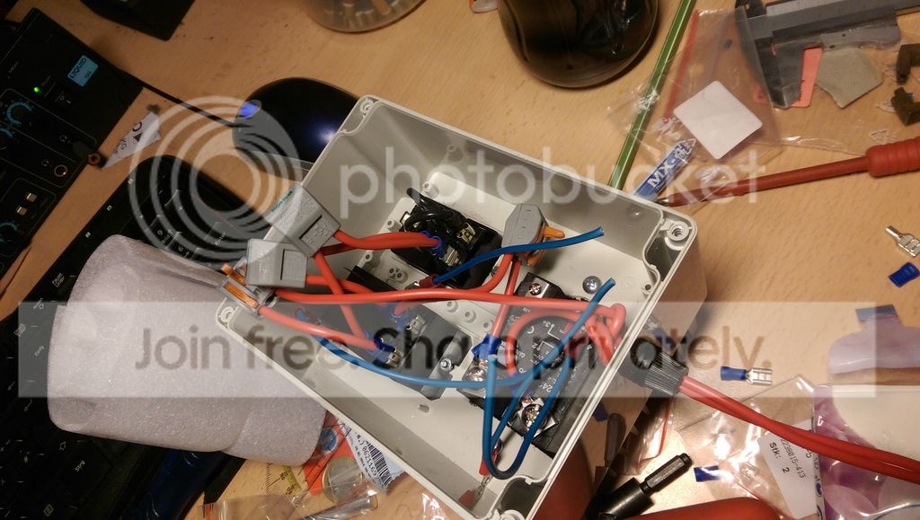

Now the pictures of my wiring:
Controllbox
Schematic

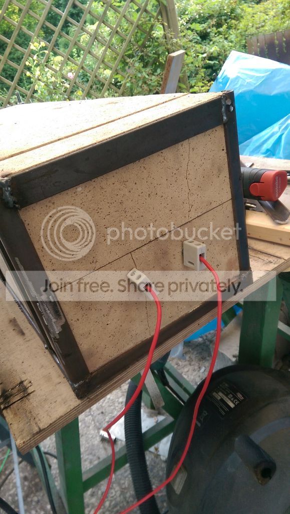

Connection from controllbox to coils
View of everything connected
Is your kiln frame also grounded? There could be, as Stacy mentioned, a floating ground. That is pretty much all I have to offer for advice. I just checked my kiln(Sugar Creek) and saw that everything, including the the metal sheathing/frame is grounded together
There may be something wrong with your measurement. As all part are grounded so even if there is a current leek to the frame it should be 0v on your meter. Unless ground and Neutral were mixed up.
Another thing to check: verify that on your outlet, gnd and neutral measure close to 0v. I used to live a a house with a disconnected ground, and it caused a lot of weird issues.
I don't see the ground in your diagram. Is your frame grounded? The frame measures 40v to what reference? If it's not grounded... well, it's dangerous to start with, but it can also be a meaningless voltage (high impedance).
The above comment about your ground source and the incoming voltage is one to check.
Also, the schematic shows a relay switch after a DPST main switch (this seems redundant). Check that there is not a shorted pin or internal short between the armature/coil and the DPST contacts. ( Note - This relay could have been eliminated by placing the door switch in the control out line from the Ardino to the SSR. The whole double main switch and relay are triple redundancy. It could have been done with a single main switch in the 72 volt incoming power line, and a door w=switch in the control circuit.).
Is this system running on US wiring, or on some other country? ( filling out your profile would have told me this)
Just a comment, but opening only one leg of the 230 volt line to the coils will leave the other leg hot. You are better off to use two SSRs. With your relay in the door interlock, you have avoided this, but it would have been simpler and cheaper to just use two SSRs.
Fwiw, details in the picture background say "Europe" the guys first message said Germany.
I agree, wiring scheme could be simplified & show or verify equipment grounding conductors exist.
Well, from what I can tell, you don't seem to have much in the way of sources for grounding your current carrying conductors. Even your control box seems to be made of plastic.
Are you using a digital meter to measure this voltage? It has the potential to be a ghost voltage, induced from the frame that runs parallel to the heaters, which are inductive.
Try measuring current to electrical ground, since current is the real danger, rather than a phantom potential. It would at least rule one thing out.

Is the frame conected to ground? It should be, but wasn't. The cable I used for grounding the frame was somehow damaged, what caused it to being grounded, and not grounded as i was shaking the cable. I changed it, and now i have no Voltage between the frame and ground.
Now to answer some of the other comments.
Im using german wiring with 230V.
There is a mistake in the drawing of my schematic. The voltage converter gets its voltage after the main switch. The Main switch is included in the power inlet of the box (box is out of plastic).
The reason i use an additional relais for turning off the coils is, that i don't believe semiconductors being failsafe. If they fail they tend to becoming conductive. So if i open the door, i don't want to have the possibility of having power on the coils. But Relais aren't that capable of being controlled by a PID so i use only one SSR for control. The additional Main switch for switching the relais (and by that the coils) on and off is used, because i want to be able to manually control if the coils are powered up without having the risk of getting shocked by leaking current cause of a faulty switch. The second advantage of one switch for general power and an other for manually powering up the coils is that i can read the temperature (voltage converter gets power and supplies the control circuit), while the coils aren't connencted.

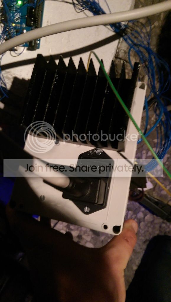

Since the box is out of plastic, i use the screw holding the cooler of the ssr, as grounding point. From there it goes to the electric cable, connected to the ground of the house wiring.
Picture of the back of the box with cooler and power inlet with main switch.
Picture of the inside for showing grounding points (marked with arrows). The arrow above shows the ground connection to the electric cable (which connects to the power outlet of the house).
I missestimatd the size of the housing a lot. But that will be changed another time. For now it's ugly, but works.
