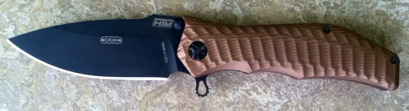

I know a lot of guys hate black blades. Personally, sometimes I like them and sometimes I don't. I have to say, in this case, I love the black blade!!
I got the assisted version in dark earth. The color of the handle slabs is almost like a bronze color, which I think looks pretty cool. The balance is excellent. I must admit, I kind of wish I could've gotten the non assisted with the bearings, but this knife is pretty nifty just for the fact that it kicks almost as hard as a switchblade, but I can legally carry it.
I do wish the choil was a bit larger so that I could comfortably slip my finger in front of the hammer. Also, the jimping on mine is fairly aggressive. To the point that it irritates my forefinger while holding it in standard forward grip. But.... I have been playing with it quite a bit since I got it yesterday.
The handle is pretty chunky, but gives it a solid grip. Overall, I'm very happy with it. It's a great knife!
Almost forgot to mention.... This is the only assisted opener I've handled that I can close one handed and that totally adds to the cool factor!
