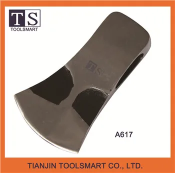

Your unfinished work already looks better than this finished example from a Chinese manufacturer:
you can tell which one was done with my off hand or in an awkward position. still have a bit of clean up on the top bevel. i tried to deepen the notch with my grinder but it didnt work that well. I convexed the cheeks with my sanding disk. the marker is there to better show where the bevels start/end
