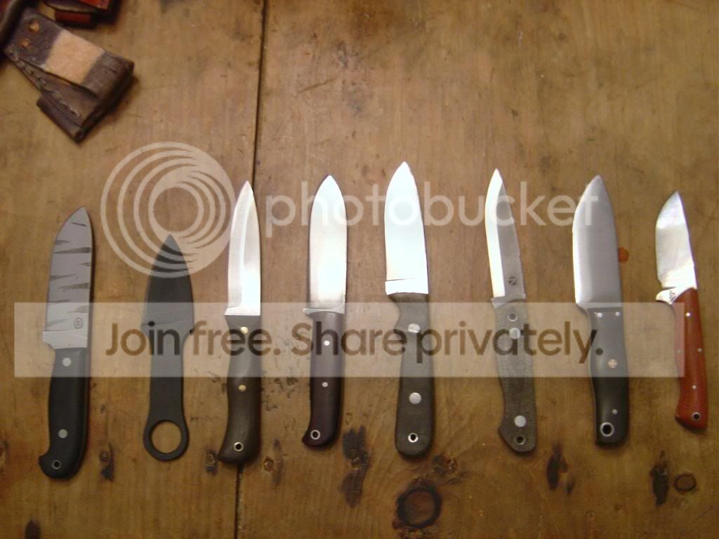

The Knives
1. SDS Knife ATS 34 Steel
2. MMHW Survival Spear 5160 steel
3. Muskrat Man Bushcraft L6 steel
4. Stephen Fowler Bushcraft 1084 Steel
5. Ironwolf W&SS Forum Knife O1 steel
6. Koster Bushcraft CPM3V
7. Fiddleback Bushcrafter O1 Steel
8. NWA Passaround Knife O1 steel
I will go through all the knives and then list the best in each category.

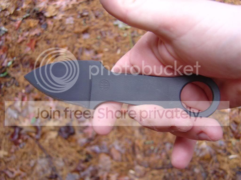

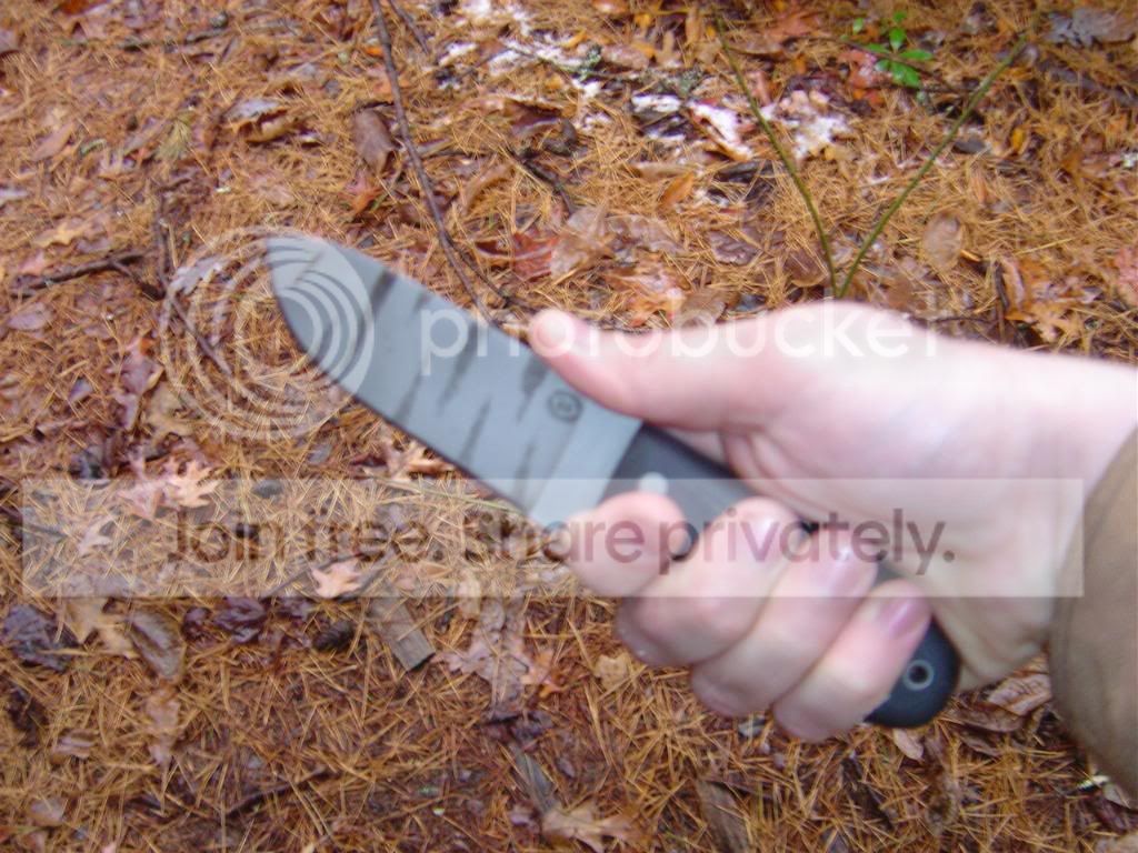

First is the SDS knife. It has thumb filing which was great for a firesteel and for grip. Handles are black micarta.
1. Finish of the knife: 9/10
2. Handle comfort: 8/10
3. Fuzz stick ease: 7/10
4. Spear point ease: 8/10
5. Edge Retention: 9/10
Finish is great. Really like the permanent stripes. Handle comfort is 8 due to my big hands, not the knife. Had to mess with the angle quite a bit to get a good fuzz stick. Edge retention was great. Push cut the newspaper with ease.

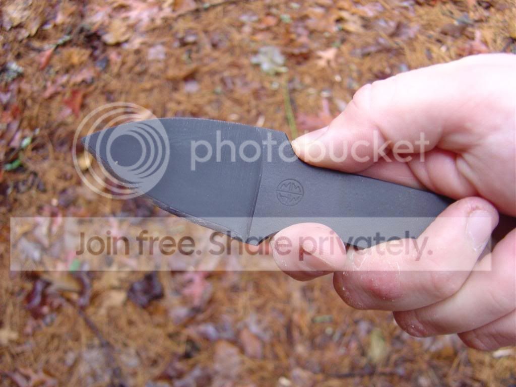

Next is the MMHW Survival Spear
1. Finish of the knife: 7/10
2. Handle comfort: 6/10
3. Fuzz stick ease: 9/10
4. Spear point ease: 9/10
5. Edge Retention: 10/10
Finish, come on, let's face it, Ted makes working knives, nothing fancy. Handle is OK, but no Matt Bailey on the comfort level. Fuzz sticks were easy as was the spear point. Edge retention was ridiculous, absolutely no signs of wear.

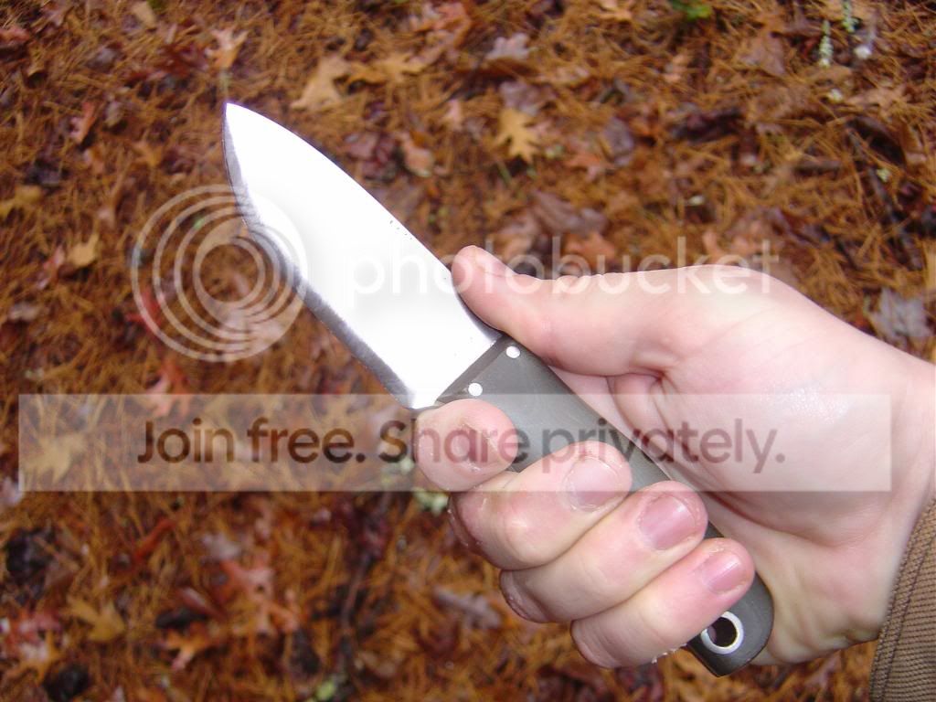

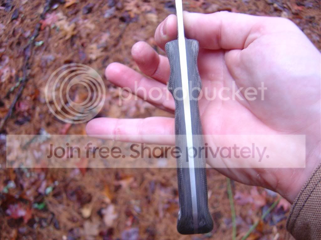

Next is the Muskrat Man Bushcraft
3. Fuzz stick ease: 8/10
4. Spear point ease: 10/10
Finish was great. Handle just didn't work for me. My hands don't fit the handle well. Fuzz sticks required a little more pressure than I expected. Spear point was too easy. Edge retention was great.

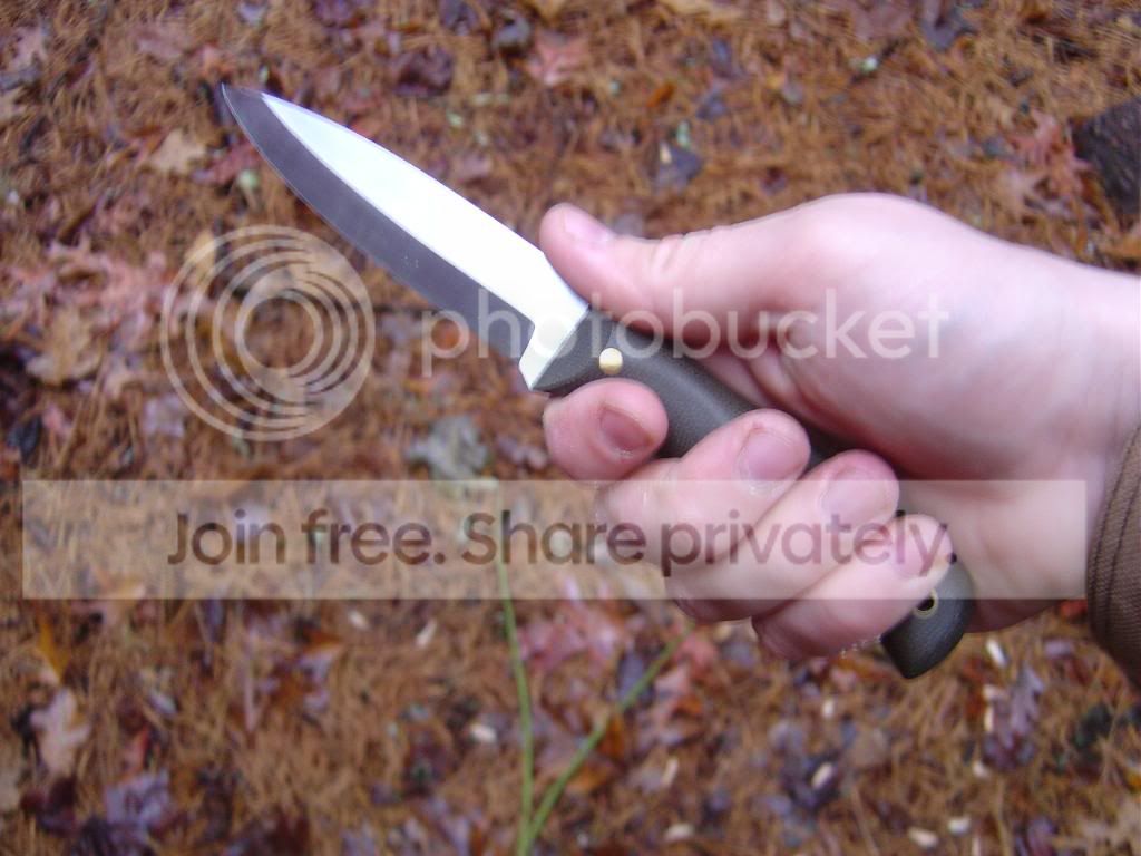

Next is the Stephen Fowler Bushcraft Knife
5. Edge Retention: 7/10
In Stephen's defense, this is one of his early knives. The finish is not what he is putting out now, but I really like the knife. Handle is comfortable, but a little short for me. Fuzz sticks and spears with no problems. Edge retention was a little lower than expected. I had a little trouble push cutting the newspaper after all the use.

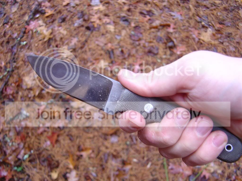

Next is the Koster Bushcrafter
1. Finish of the knife: 8/10
2. Handle comfort: 7/10
3. Fuzz stick ease: 10/10
Finish is good on the Koster. Handle scales are a little thin for me. Fuzz sticks were ridiculously thin. Easy to make a spear. Edge retention was a little confusing for me. 3V holds an edge for a long time I know. This knife was the easiest to use while working with wood, but did poorly push cutting paper. It could be from the toothiness of the steel.

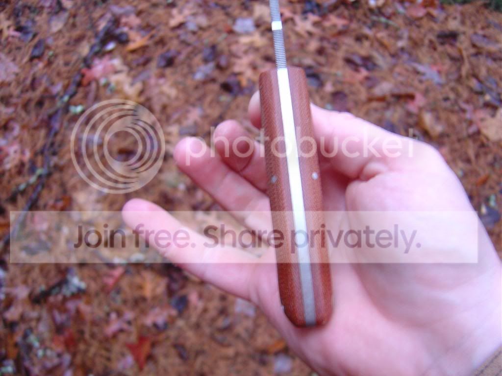

Next is the Fiddleback Bushcrafter
2. Handle comfort: 10/10
Finish is great, as on all of Andy's knives. His handles are amazing. Flew through the fuzz sticks, spears, and push cutting with no problem.

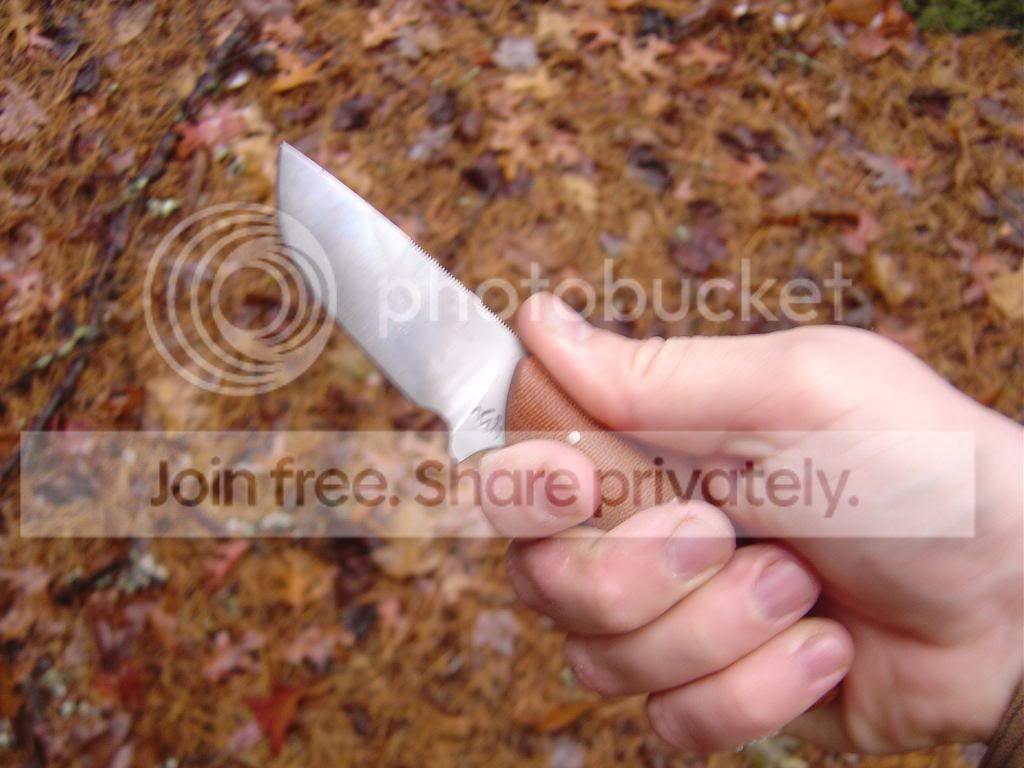

Last but not least is the NWA Passaround Knife
1. Finish of the knife: 10/10
Finish on this one was top notch. It has extended thumb ramps, which were great. The handle was really comfortable. Fuzzies, spears, and push cutting were easy.
Results and Overall Favorite:
Each Category
1. Finish of the knife-Goes to Nick for overall Finish. Pure handles goes to Fiddleback
2. Handle comfort-Fiddleback without a doubt. After hand sanding to my hands, the W&SS Forum knife is tied with Andy's.
3. Fuzz stick ease-Ironwolf Forum Knife tied with Koster Bushcraft
4. Spear point ease-Muskrat Man tied with Ironwolf Forum knife
5. Edge Retention-Ironwolf Forum Knife tied with MMHW Survival Spear
My overall pick from these, from the makers, is the NWA knife. Nick did a great job on these from top to bottom.
If I had to pick one knife from these to carry with me, I am going to take my reworked Ironwolf Knife. The steel is great and the handle is fit to my hand now.
