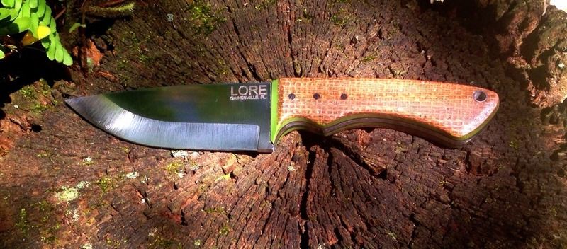

This is the first knife I've posted to the forum. Constructive criticism is appreciated. Thanks.
440c Stainless w/ a Rockwell hardness of 60 from Peter's
Burlap Micarta Scales
Toxic Green G10 Liners
Vulcanized Black Liners
Micarta Pins
Stainless Lanyard Tube
Drop Point Hollow Ground Blade

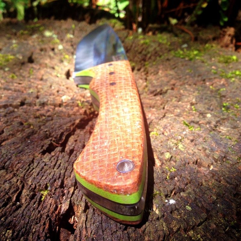

Looks really good. The only things I would change are to take the grind up higher(unless it's supposed to be a scandi grind) and to round the scales some. It would make it much more comfortable.
^^ I agree with Matt
Also, the plunge line (where the grind begins) is slanted the wrong way. A good rule of thumb to go by is if you're trying to make a straight/vertical/ 90 degree plunge line, slant it backwards 1 degree, so it 89 degrees. This "rule of thumb" also applies to guards as it's generally gives a better "flow" and is more pleasing to the eye. I'm guesing you didn't grind it that way on purpose but it's just something to keep in mind. Other than that I thinks it looks good! :) .

Good pointers. It does feel a little square in the hand. I didn't notice the angled plunge untill you mentioned it. I'm definetly going to keep that "rule of thumb" in mind. Thanks!
