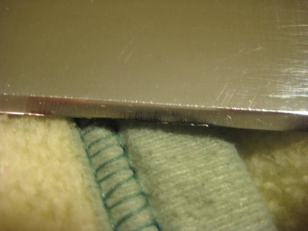

I accidentally chopped a pea sized stone in half on the chopping stump. I heard a ping, and felt it.
Cut the stone in half, and I looked at the edge, expecting to see a huge dent or roll.
The roll was simply tiny! It steeled right back into place. Just a few passes with a round screwdriver, and a few swipes on my stone. You can just see the ripple here, before I fixed it.
