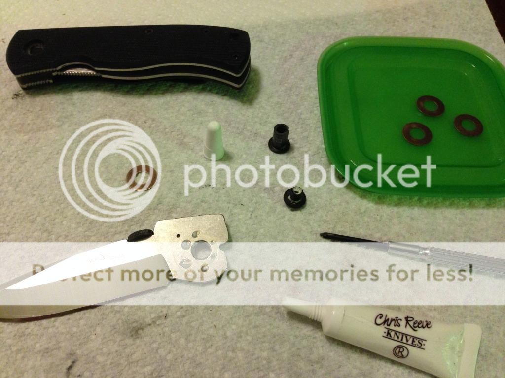

Disassembly is complete and cleaning is in progress... I am using Benchmade's Blue cleanser and boy did this thing need a serious bath!
I found it interesting that the pocket clip had to come off in order to get one of the standoff screws out.
Question: I have (4) washers in this thing--is that normal?
they must have been replaced because emerson knives do not come with copper washers and only have 2. that said the washers they do use, nylatron are kinda thick so maybe the original owner doubled up? dunno. Emerson's are great, and easy to assemble/disassemble and fix. The nylatron washers dont need any lubricant but I have used CRK grease on occasion and it works really well. may not be necessary but i have seen the benefits. enjoy the blade.
Exactly. To each is own I guess. 2 washers on each side really doesn't make sense to me.

I'm sure you can pick up the original nylatron washers anytime you may need them. It looked to me like the old owner may have swapped them out. If you get a chance and if you have calipers, check the distance between the liners.
I know the Commanders have .185 at the pivot between the liners. There are two .30 nylatron washers + .125 on the blade which makes the .185. I'm guessing that those washers you have in your knife are .15 a piece. I'm just curious is all so no big deal if you can't get measurements.
