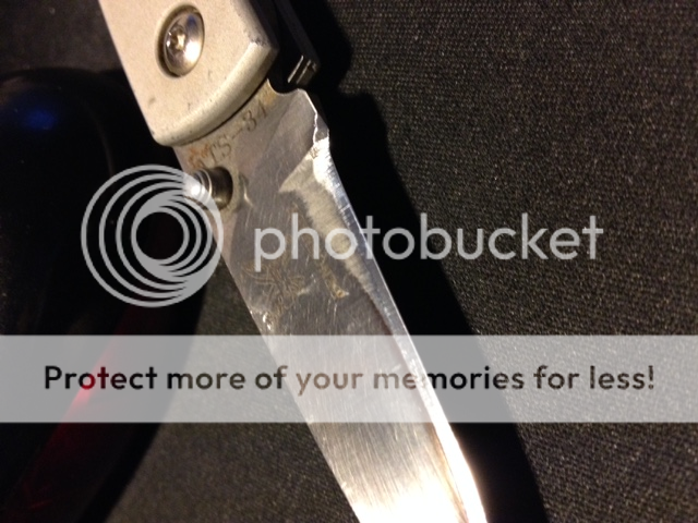

I am kind of upset...
My thoughts are: is the knife sharp? If so, he did what you paid him to do.
From the looks of your knife, it looks like it's been a user and looks hasn't really mattered, right?
It's like if I want to get my car wash instead of doing it myself, I can go through the drive through car wash of the gas station or go take my car to a car wash business where some people will towel it dry or have a detailer wash my car. All three types offer differing services at different price points. Whatever service I choose dictates my expectations. I don't go to the gas station car wash and expect the same results as I would have gotten from a detailer. Perhaps you took your car to the gas station car wash.
Actually,no it hasnt been used much at all. You are in the minority.

I had him sharpen a Henckels Chef Knife first,,he didnt beat up the blade like he did here..I dont know if he did a great job or not,,it was sharp for sure,,the bevel seemed very wide when he was done,,nothing like the factory edge.. Now,the Benchmade..I don`t understand why this would happen.. So Stupid Tax? I don`t like that choice of words.

I suppose you may have some valid points,but to scratch up the blade and act as if its ok? or to be expected cause of the jig blah blah..nonsense.. Just a shame.

As far as the scratches I think you could make them go away and levae the knife in better looking shape just using some 220 grit alum oxide sandpaper and blending that scratched area in sanding lengthwise. when the vertical scratches are all blended in just move up in grit to 320 then to 400 and you should be good to go. Stay away from the edge itself and use a flat ice cream stick or flat piece of metal to hold onto the sandpaper so you don't round over the edge bevel. You could do the whole blade after you blend the scratched area in and do both sides so they both match.
Be sure to use wd40 as a lubricant with the sandpaper to make it last 10 times as long , cut better, and keep it from clogging.

If you're saying the knife was pristine and didn't have the discoloration on the blade near the hilt and what looks like normal use marks on the handle itself when you gave it to him, then you you have a case to be more than upset. I take it you won't be sending him additional work any time soon?
