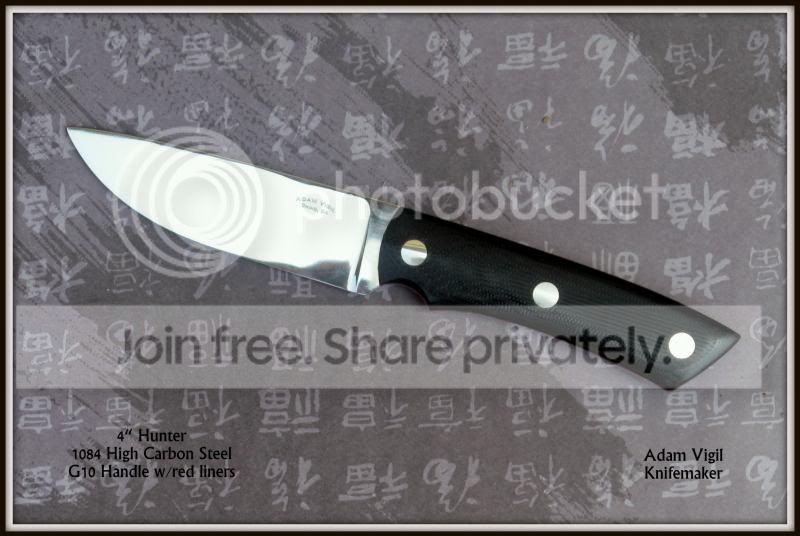

I read S.R. Johnsons write up on using cork belts and watch him in his video use them so I thought to give them a try. I picked up a couple at TruGrit and broke them in. There is a specific procedure to breaking in a cork belt and it takes some time and effort to get it ready to use.
Grinding down to 220 grit and putting on a Cork Belt 400 grit really puts a nice smooth finish on the blade and any remaining stratches often can be removed with the cork belt at 400. It removes metal much slower and so getting up into the plunge to clean up and polish it works well and there is a less of a chance of screwing it up.
After the 400 Cork Belt I put on the 1000 cork belt and work over the blade. It nicely polishes the blade and brings it to a high luster. Once the handle is install and sanded I used the 400 Cork to gently work the G10 and clean up the finger groove and polish it nicely.

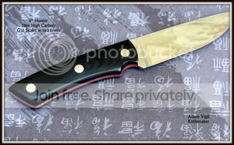

Here is a hunter I am working on that I used the cork belt on the blade and the handle. After using the cork a quick visit to the buffer to clean up some tight areas and remove some light scratches.
For what they cost they are a great deal
The photos were taken in the lousy light of the day...sorry about that. This is my humble attempt at a 4" hunter
First off, very nice knife. I like the lines. Are the liners g10 or fiber?

Thanks... the red liners are fiber material.
