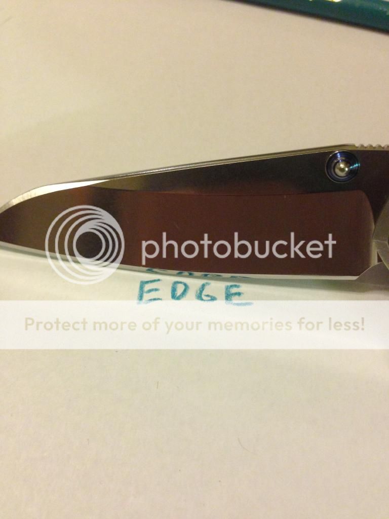

I had to get it figured out tonight. It is midnight and I have to get up in 5 hours, but it was killing me. My suspicions were correct--one bevel was slightly off so that the stone was NOT hitting the apex. I have now come to realize just why a Sharpie is an important tool when sharpening!
I took the edge all the way down to a 120 stone before it hit the apex on both sides evenly. I worked my way, slowly, up through 1K stone and then through the polishing tapes.
It is an edge I can live with now. Not perfect. There are still some uneven parts on the bevel that will eventually get sharpened out, but I have already removed enough material. The heel needs a little help too, but this edge is 100 times better than what I was able to achieve before!

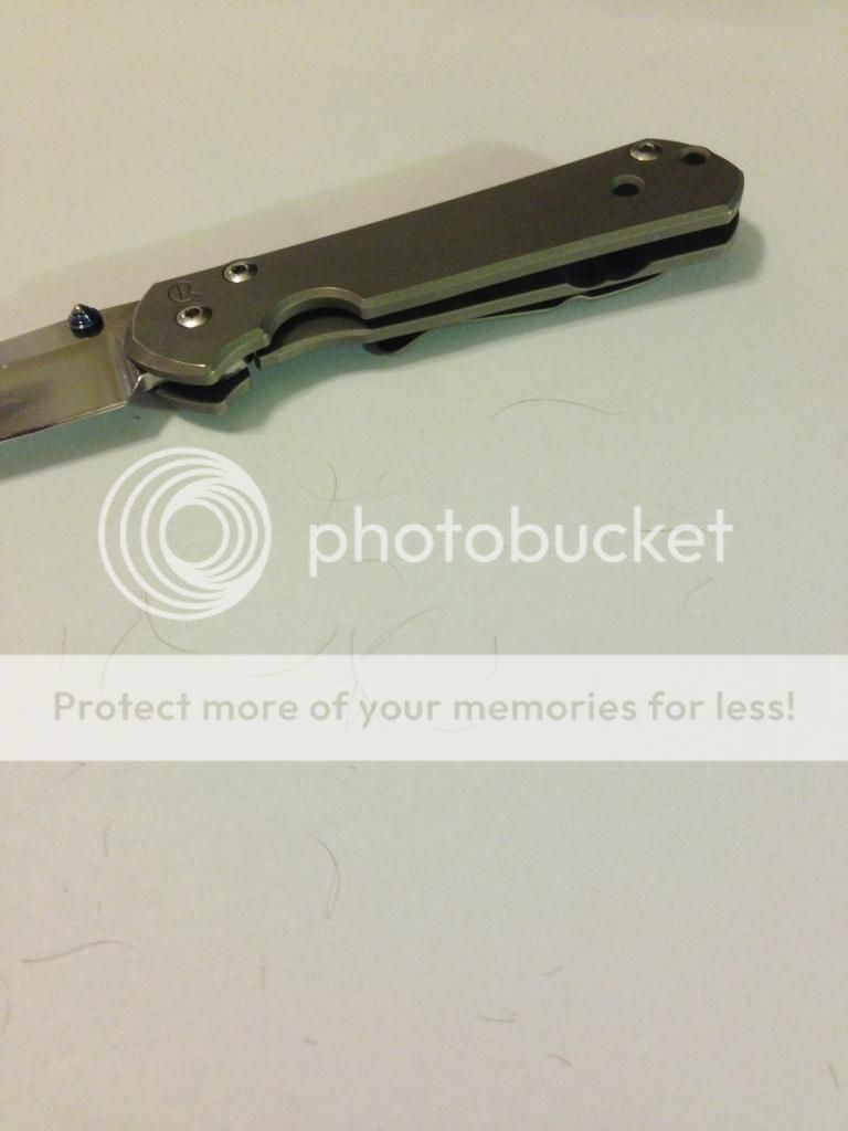

Pics:
Pretty cleanly sliced copy paper, notebook paper, and newsprint.
That's arm hair! (Gross)

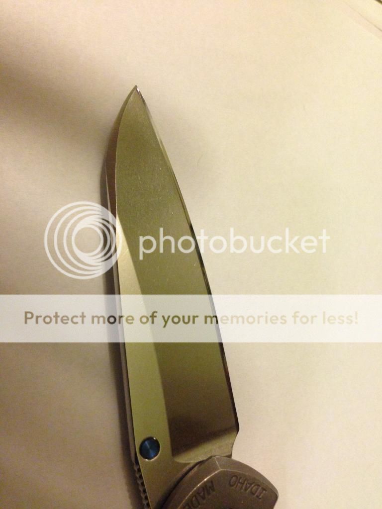

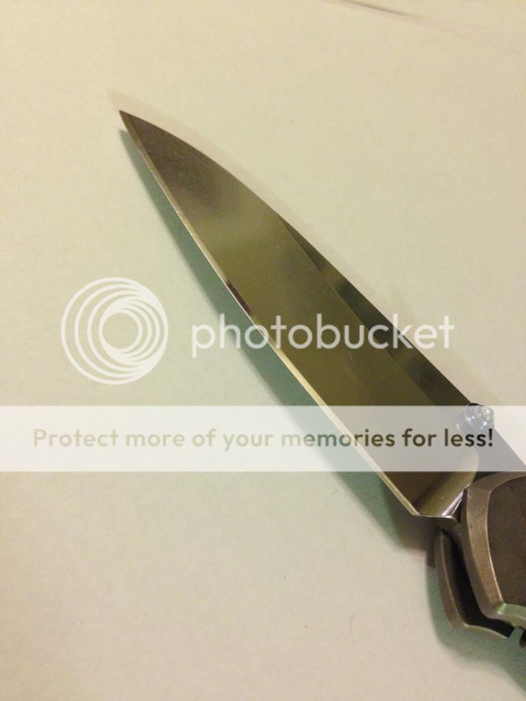

A few shots of the edge:
