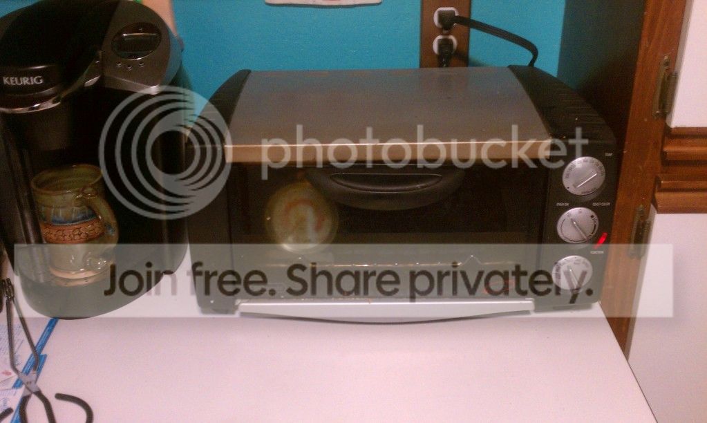

Just like the title says. I call it the "junk drawer straightener".
Here it is in my "super high tech tempering oven"

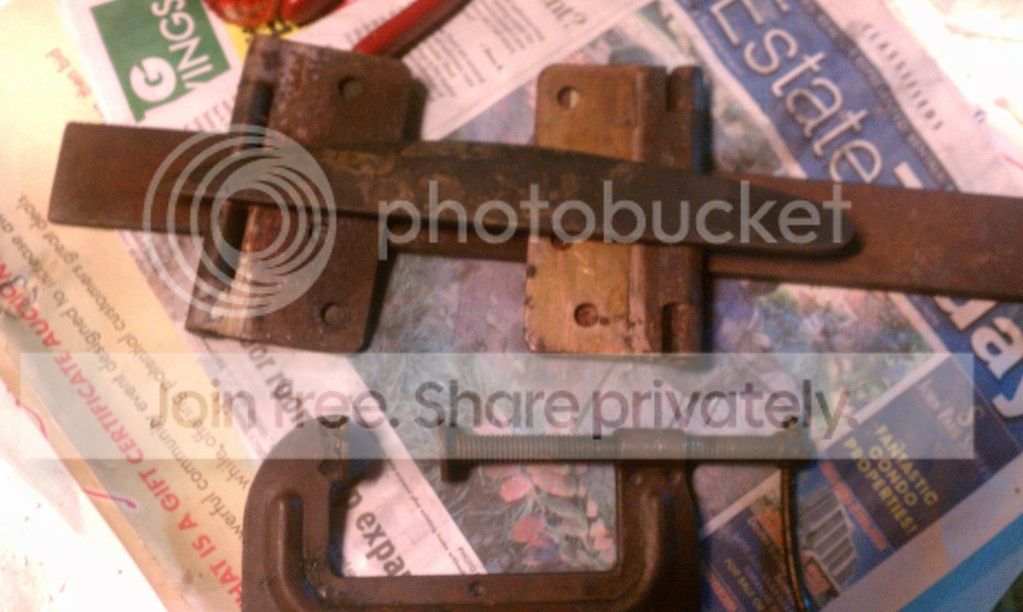

It's seen alot of use this past week. I just got a batch of 1075 from Admiral steel that seems warp-prone even after triple normalization. Three tanto ground out, two wandering tips, and an almost kink near the ha-machi on the third. All three blades quenched in the same temp oil on the the same day with nearly identical grinds. Nomalization was the same. Also, the knives are almost full thickness to within 3/8 inch from the tip.

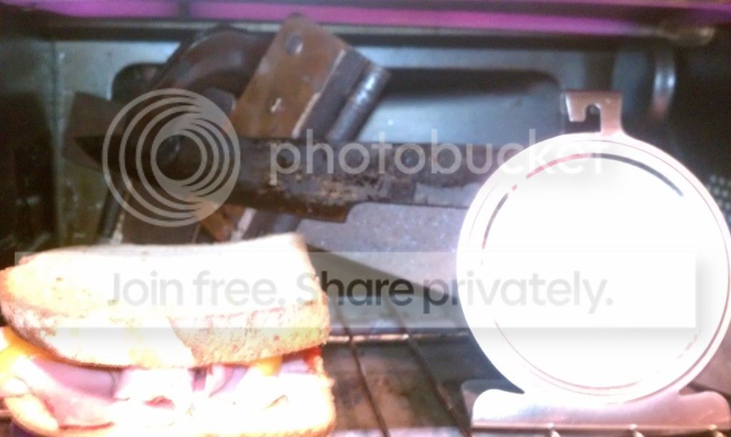

Maybe I'm missing something here but what are the hinges for? Or are they there just to hold the 2nd piece for the photo? BTW, your oven looks better than mine!
I use the hinges as risers and clamp between the two riser with the c clamp to achieve the bend that I need. I stick the whole mess with a knife in it in the toaster oven and let it bake for 2 hours @ 400 F the first time, and 2 hours @ 425 the second time. I've got a photo that shows it in use. Actually, I'm tempering the sandwich and toasting the warped tanto.

Thanks for the explanation on the hinges. I just couldn't wrap my head around why you had them in the pic. Makes sense now!
The hinges work surprisingly well with the single c clamp, instead of having to use a bunch of c clamps and shims. There's a Moderator on here who posted his method of straightening which inspired this ugly beast. Oh, and you're very welcome for the explanation.
