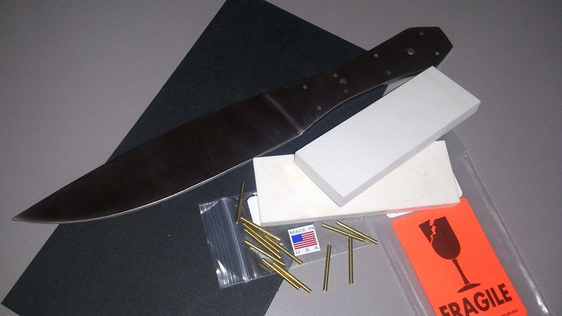

I thought that good advice. Buying an inexpensive knife blank would ensure, that I got to handle a coffin handle prior and making up my mind whether or I like that particular and to some peculiar knife handle shape.
Last year in the summer time I ordered a cheapo knife blank and met up with my buddy to make a coffin handle Bowie.
My buddy Dravis did most of the 'heavy lifting' in regards to the chores, while I mainly fashioned a few pins and mounted them in the handle.

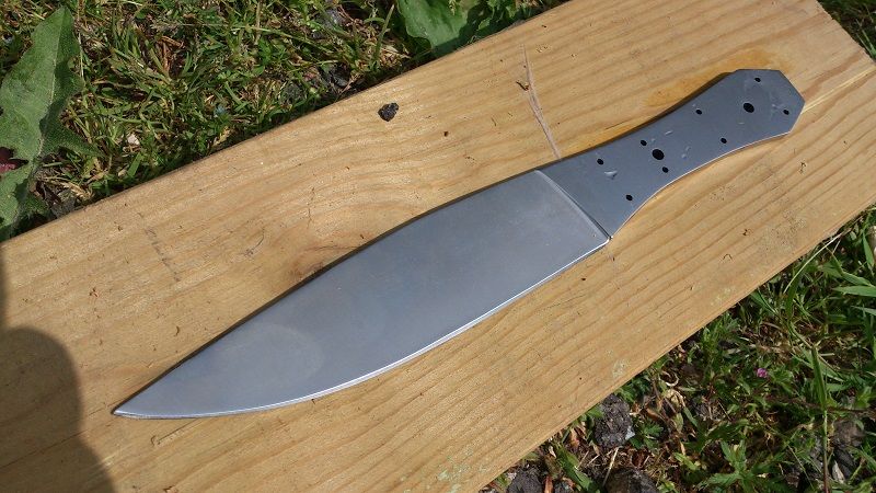

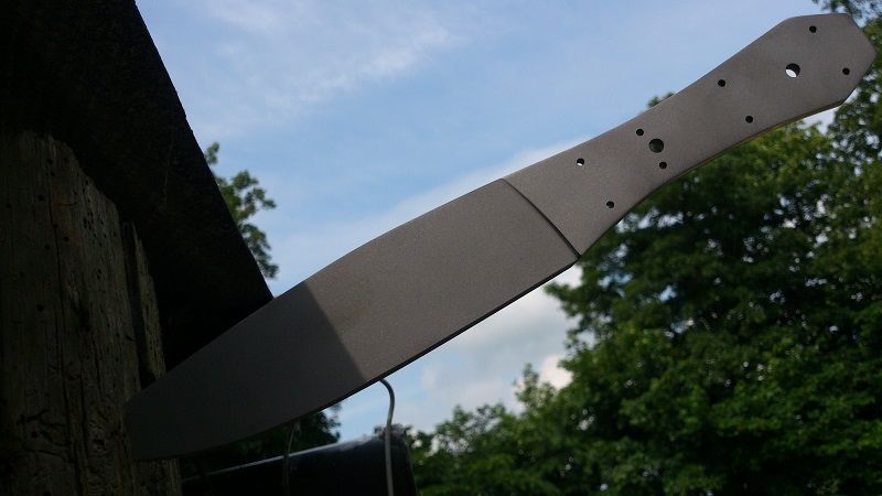

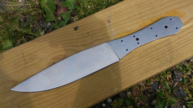

First the cheapo knife blank. Its of a shape that some call 'Natchez.' I believe the vendor calls it the Appalachian. The grade is not mentioned in the sales blurb, but its stainless steel or SSS (Some Sort of Stainless), as Ebbtide coined it:p
I would have preferred carbon steel or some super steel, but it really didnt matter, as this was merely to be a cheapo testbed for a custom knife.
Further more, the blank is so cheap it doesnt matter.
Its a beefy knife blank and should easily could withstand some use in the field.
The blank came polished, which I didnt much care for, so a quick and dirty blasting job was called for.
As for scales, Im a fan of Westinghouse or similar antique 'ivory' Micarta. But I was able to put my mitts on some non-antique looking white ELFORYN instead.

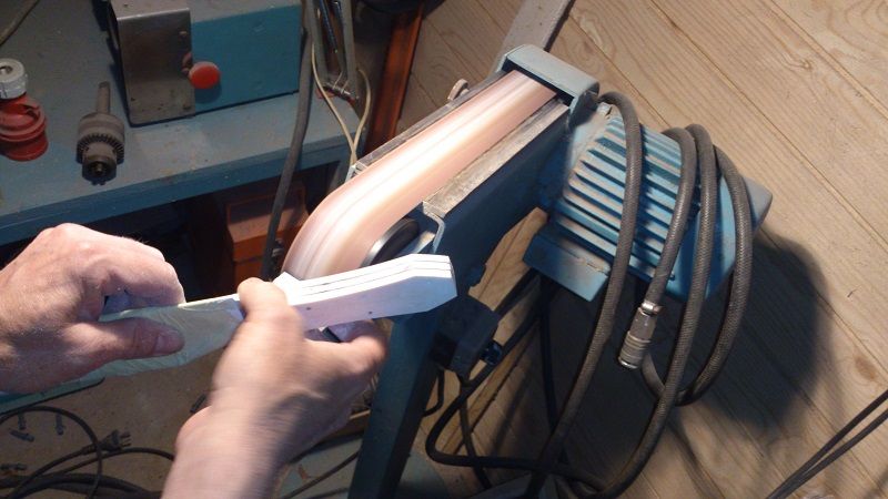

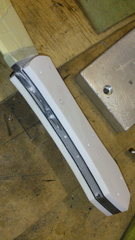

A few pics of the mounting process for the handle scales. I went with a black liner to offset the white Elforyn and small pins instead of only a couple of larger pins in the middle for that period look.
The end result

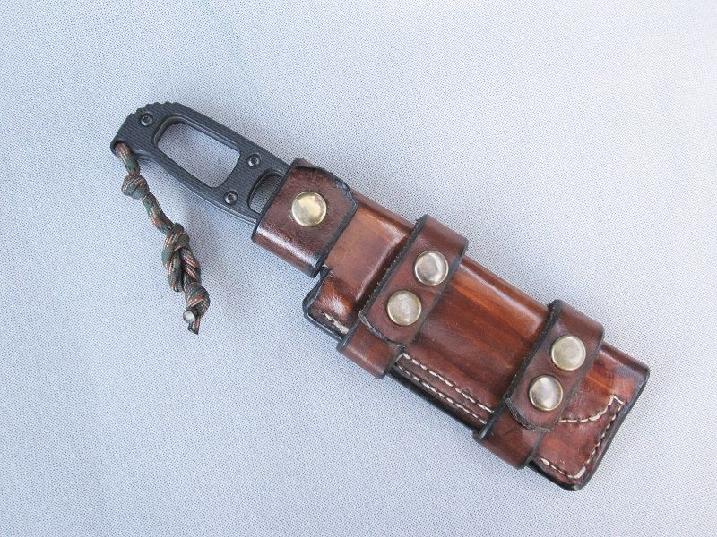

As for the sheath, I want to thank JParanee for drawing my attention to sash carry, which I now know is one of Joes preferred carry methods. Ive certainly become a big fan after making yet another test 'vehicle' - a quick and dirty hurriedly made sheath for the carrying of the coffin handle knife sash style. I made it to look old and abused. Please keep that in mind. I can make prettier sheaths though not quite up to Ebbtides standard. This was only to test the knife and intended to be made fast and to discard, did I not like the carry mode. How ever, Im a believer and kept the sheath, as it works fine. In time, Ill make another for the Bowie knife.
Its carried IWB and with a static line, which ensures, that the sheath releases the knife. An excellent and very comfortable mode of carry IMO.
Here the sheath resting on fifty inch Kudo horn which I bagged in Africa. Ive used the coffin handle Bowie for a camp knife when hunting though not internationally. Its does great service.
IWB carry. It works. It more than works as a matter of fact.

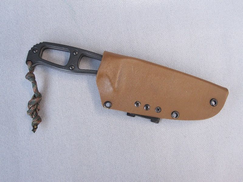

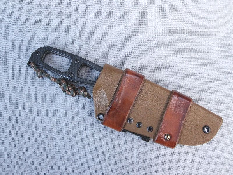

Thank you. Big fan of your sheaths - I especially find the beltless sheath concept nifty.
Here a few of my latest sheaths. None of them beltless though.
Leather scout carry for GEK EDC
Kydex scout carry for same knife
Combo with leather straps. Not really neccesary as there is a TekLoc on the back, but I experiemented with using either the leather straps or the TekLoc
Leather sheath for a custom chopper. I got the chopper, then made the sheath. Its with multiple fastening points for either strap/belt or MOLLE carry on rucksack.

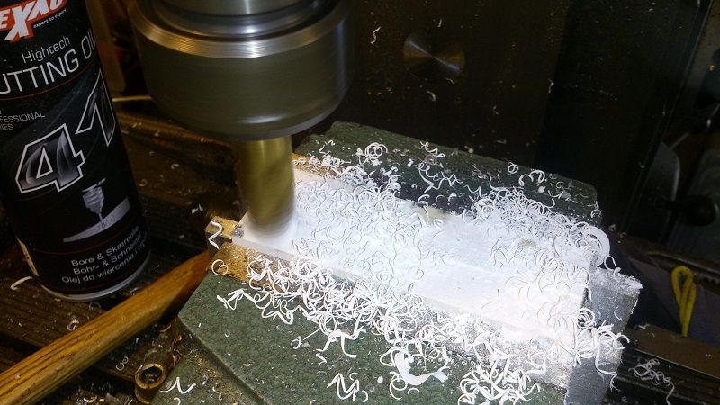

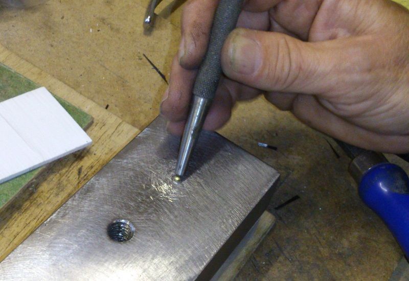

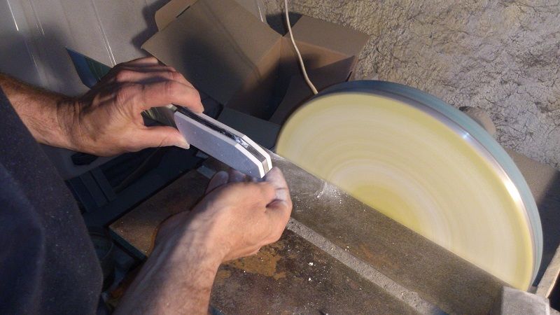

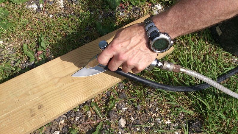

A few more pics from the process:
Shaving a bit of the ELFORYN mass off
Sand blasting the blade
Before blasting
After blasting
A peek at one of the pins, which I got to shape and put in the handle

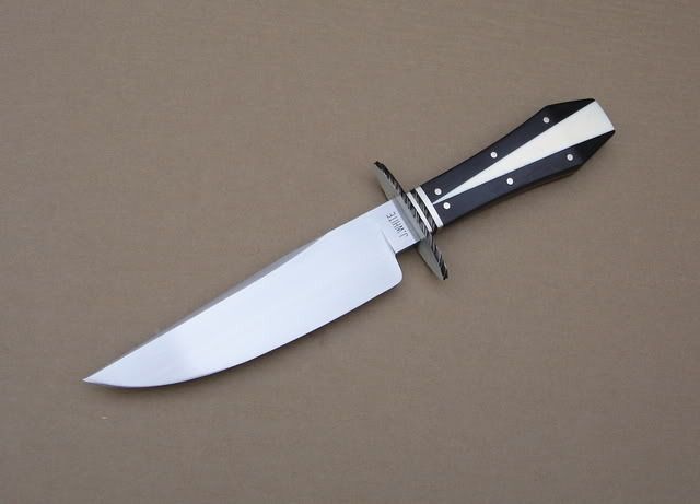

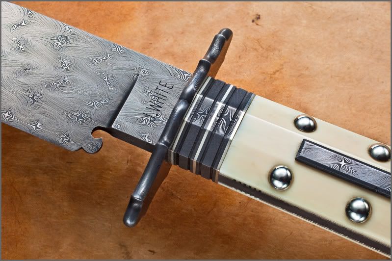

Scout, you did good. John White would be an excellent example to follow on coffin handle knives. He was as good as you get with them.
Thank you very much, Sir.
Means a lot.
John White indeed makes beautiful knives.

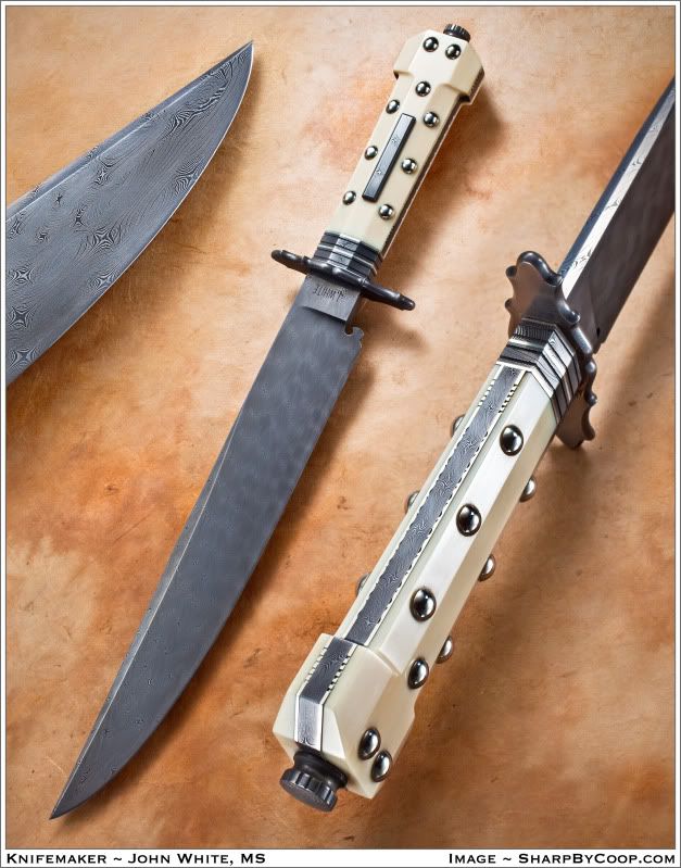

This I find one of the best looking coffin handles ever:
Not only is his coffin handle knives great, but I keep comming back to look at this Dogbone handle Bowie ever since I first saw it a while ago:
Simply fantastic

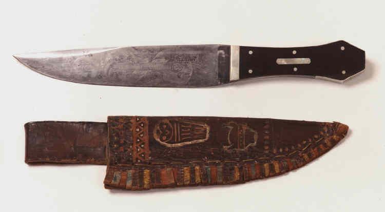

Im a big fan of most Bowie knife styles - Perkins-Shively, Searles et al, but the style of the knife in this post has a special place, I must admit.
The simple 'Tachee' knife looks very good.
http://antiquebowies.com/antiqueBowies/historic/tahchee/tahchee.htm
Also the James Black knife in the Saunders Museum, which I visit when ever I am in your neck of the woods, is a favourite of mine.
I didnt get to take a photo of that though, as cameras are not allowed there. No doubt there are some pics floating around out there though.
