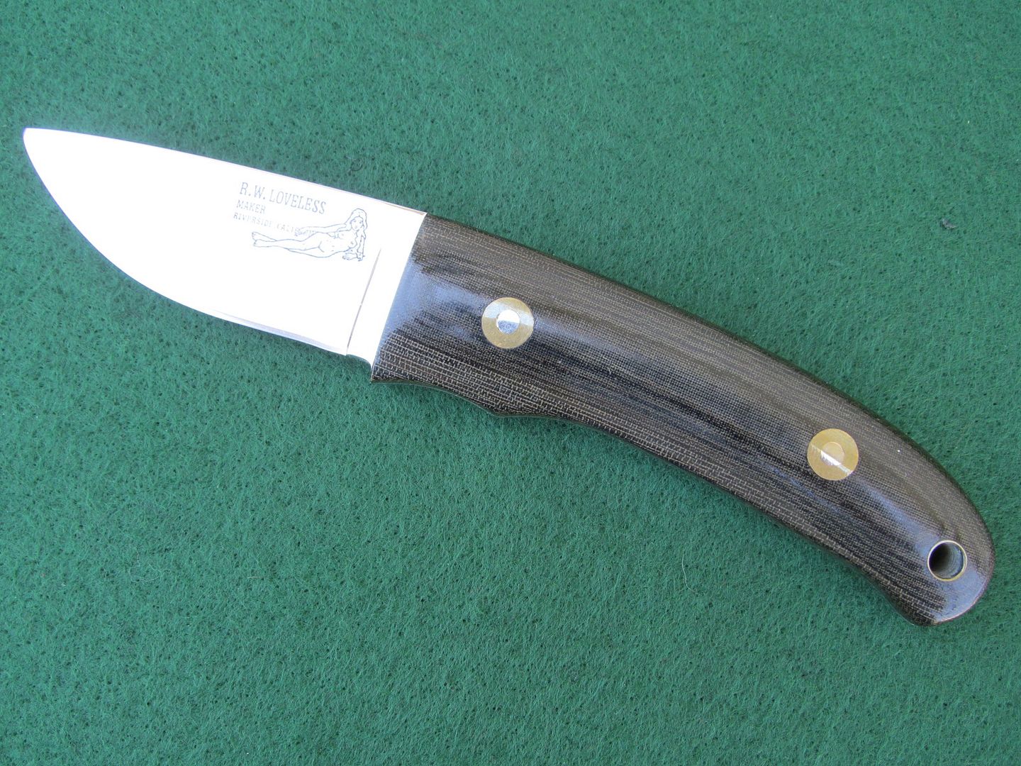

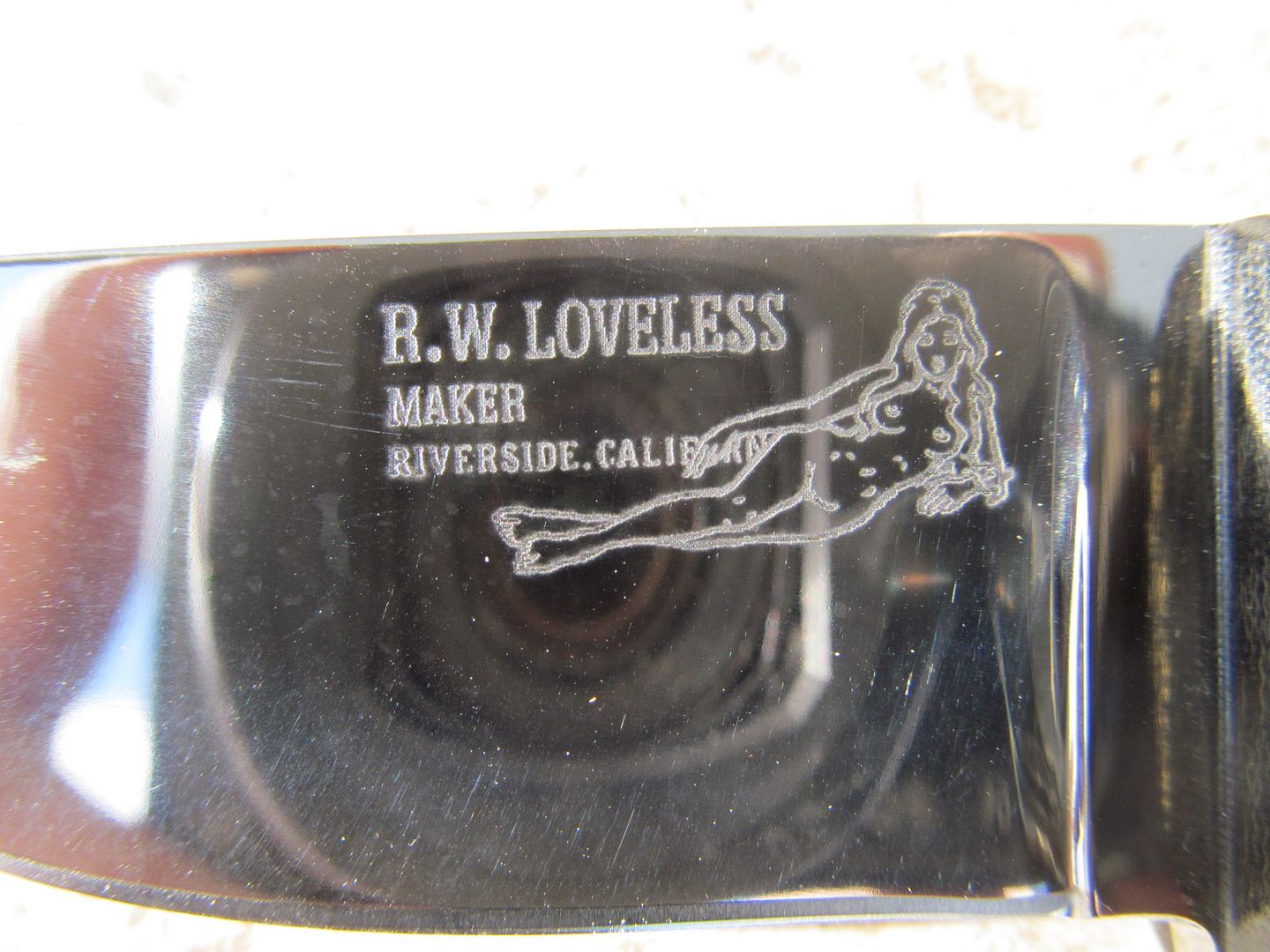

A few months ago, a local guy called me and offered to sell me a Loveless for $500. I naturally was interested and bought it. When I had a look it doesn't appear to be very good quality as far as design and workmanship although the materials and the logo are spot on. I later contacted Jim Merritt and he said he didn't make it and he said he's sure Bob didn't make it.
Now what do I do with it? This may be a good discussion as I'm sure there are other questionable knives out there. Jim did say the materials and the logo were right and it may be a students work. He said students weren't allowed to use the logo but maybe one of them did anyway.
I'll get a shot of it asap

OK I located my pictures from back in April. I guess time flys, I thought it was just a few months ago.

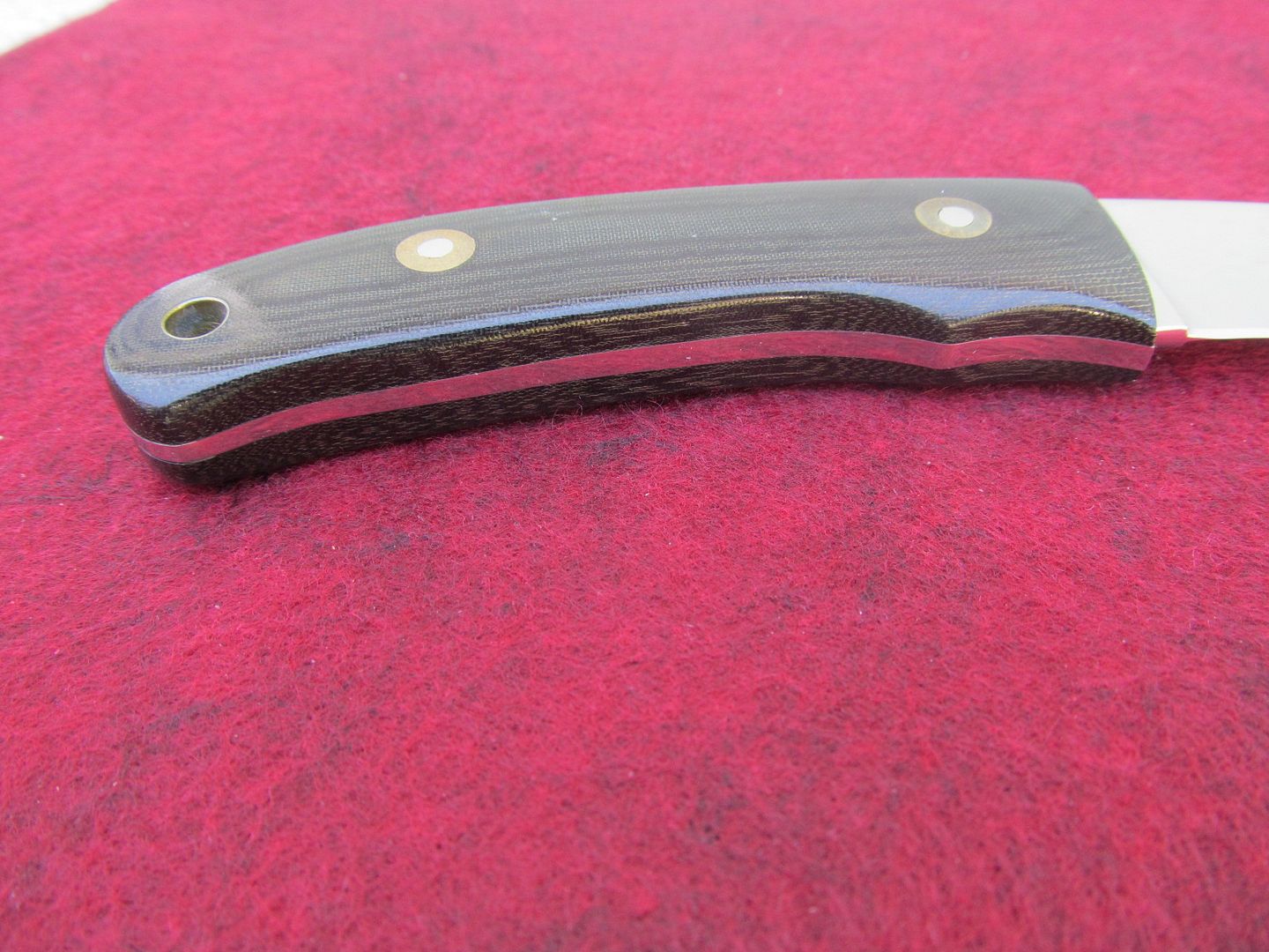

There are an incredible number of tip offs that would not be a Loveless.....the fit, the grind, the lack of spacers, lack of a tapered tang, the photo etch looks wrong......I think someone made it, and had a copy of the stencil made.
There are good counterfeit Loveless knives, and not good ones. This one was not real good.
If anyone out there can tell me that I don't know what I am talking about, I'd really like to know.

I think you identified some compelling factors supporting forgery.
However, I'm not sure I would use 'fit' (or lack of it) as as an indicator as I've seen authentic Loveless pieces where fit & finish was questionable.

So many things wrong with that knife.
Someone needs his ass kicked hard.
Two additional things...Loveless was an engineer...It's likely he'd have spaced the fastners
more appropriately.
Also the screws...he used 8-32 stainless screws and (usually) 3/8" brass round nut and washer.
Those appear to be large pins and washers(??)...

It's a fake because:
1. The handle fasteners are the "mail order" ones, lots of places sell these. They aren't true Loveless fasteners, and are nowhere as strong.
2. The pattern isn't right, looks like they tried to make a Randall ... but it's quite a ways off.
3. The handle grind looks like it was done by a beginner, it's too flat, no contours. Maybe files and sandpaper were used to make the knife, I doubt a grinder was used.
4. The handle material looks like Green Linen micarta, never seen this stuff on a true Loveless, Green Canvas ... but never Green Linen.
5. Plunge grinds look like they were done by a beginner too. Straight drop, no contours ... true, Bob's grinds in the very early years could look a bit rough, but remember his machinery wasn't great, and he wasn't mirror polishing back then. True mirror polishing didn't come along until Steve Johnson. The nude logo didn't come along until later too -by then the plunges were pretty decent.
6. No tapered tang, no red liners.
7. Jim says it isn't real. ;)
The logo is real, but stuff like that can be copied by any immoral scum. It also appears to be laser engraved?
Hope this info's helpful Bruce and you can get your money back.

I do not have much to add but the tipoff to me is the lack of tapered tang, no liners.
Bolts look off and that choil is suspicious ( and if course the price!!)
Dave
I believe that Loveless made some knives without tapered tangs, and maybe (?) without liners, too. And as Kevin has pointed out, fit and finish from the Loveless shop over the many years was . . . variable.
Of course there are many here who have forgotten more about Loveless knives than I will ever know, but one thing stands out to me. That handle. It does not look to me like anything that I have seen from Loveless. It looks amateurish. No palmswell. A pseudo "improved handle" type that definitely does not look improved to me. It does not look to me like it was constructed by anyone who had given much thought as to how a human hand is shaped - and that to me is one of the hallmarks of Loveless' knives. Nothing about it speaks to me of the kind of functionality that I see in Loveless handles. And as noted above, this appears to be particularly cheap micarta. If Loveless had actually made that . . . I would have been surprised.
