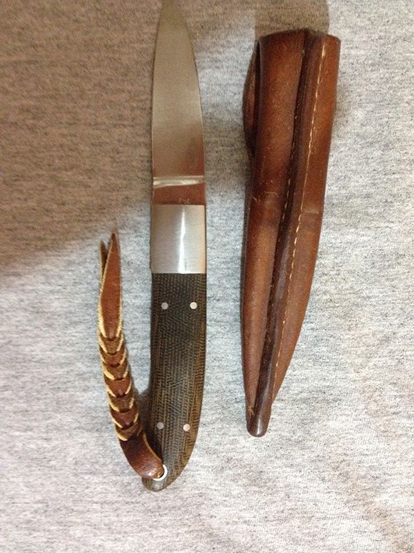

[/URL][/IMG]
This is not a Loveless sheath.
Not sure about the rest.

Don't mean to cause controversy, but the way the leather was worked, the sheath has Bob's handiwork all over it.
Stiff horn and City knives had that type/style of sheath.
The way the knife was made suggests that it was from the early 80's. Those look like Jim's grinds, with Bob's "polish." Bob would buff a polish on using a red compound that wasn't a true mirror polish (it was a satin-type of finish) ... Jim really elevated the fit and finish of the knives when he joined Bob in the early 80's.
The grind is a "rebated" grind, there wasn't much choice when it came to available stock thicknesses back in the day (3/16" and 1/4" -nothing thinner), so Bob would have Jim grind past the spine (some people thought that this was a grinding mistake), but it was deliberate to thin the stock -much like a "rebated rim" on a firearm cartridge case. This small knife would cut better because of the grind. -Loveless knives were made for use.
