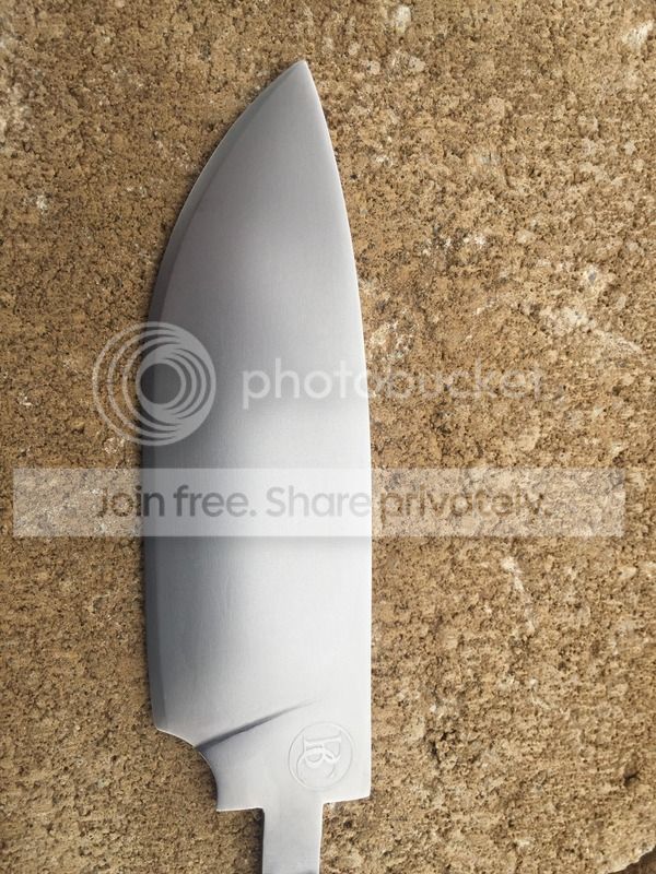

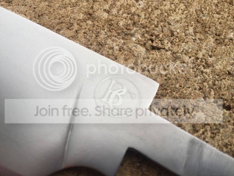

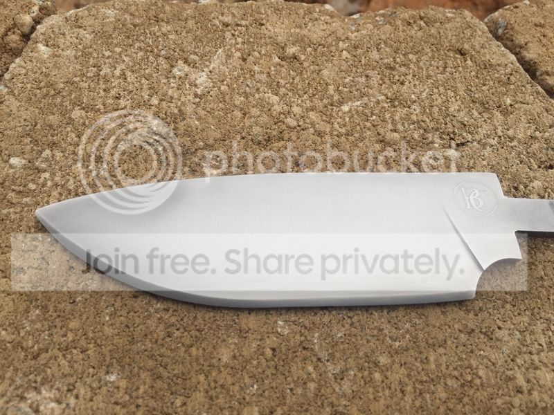

So I made me a little skinning blade using stock removal of an 01 flat bar. I sent it to Peters Heat Treat and had it heat treated and had them differential treat it for a hamon. Got the blade back several days ago and wasn't real happy with the hamon line definition (not Peters Heat Treat fault) as I am picky. So I watch a million videos regarding etching and bringing out the hamon. This afternoon I put on my rubber gloves cleaned it off with acetone real good and dropped it into the ferric chloride. At the 10 minute mark I pulled it and cleaned it real good. I applied my makers mark (vinyl logo) and dropped her back in there. I let it soak for 40 more minutes cleaning it twice in that time period. I got it out and neutralized the acid and let it sit for a little while. After an hour I took some micro 3000 grit sandpaper and smoothed it out real nice and then polished with silver polish. The blade turned out to be a perfect light gray which is exactly what I was looking for and my makers mark turned out perfect. You can see the hamon if you get it in the right light but otherwise it's almost invisible. Since I'm not happy with the way the hamon turned out I'm thinking of leaving it as is since I am pleased with the finish. What am I doing wrong for future reference?
i would try etching it for a short period of time, just enough so you can see the temper line to your satisfaction and then use the silver/metal polish by hand with a cloth. nice blade shape :thumbup:

I hate to mess up that logo transfer, especially since I'm not happy about the hamon design on the blade. When I first etched it I could clearly see it but once I put the polish on it, it just disappeared.
I have never tried to get a hamon on O-1 because it isn't shallow hardening. I would expect very little activity to show.

O1 will not really show a well defined hamon, unless you do a certain heat treat sequence using an O/A torch and a lot of control. Differentially heat treated, like an edge quench will get you a line. I think you left it in the etch way too long. For hamon etching I do a ten to fifteen second etch, then polish with flitz or something similar and 4f pumice powder. I may clean and re-etch a second or third time to bring out more activity. Very short etching cycles.

Whoever told you O1 makes a fine hamon doesn't have a clue. You "may" get a differential hardening line with O1, but doubtful you will ever achieve a "hamon". 1075, 1095, W1, W2, White steel, these are used for obtaining a hamon.
When I started out, I was misled by YouTube videos showing a hamon in O1. It was basically an edge hardened blade with a smudgy line. You need shallow hardening steels like the ones mentioned above.
You wont get crazy activity from O-1. Like others have said it is not shallow hardening, rather more deep hardening. You may be able to sharpen the line you have on your first picture, IE make it more defined, but its O-1, so just be happy with it as a great blade.
But if you do want to try bring it out, I generally use hot vinegar with a few drops of soap to etch. Paint it on with a paintbrush or one of those sponge brushes and neutralize in baking soda water after about 5 minutes of painting. Pull sand with 2500 grit paper or use powdered abrasives to clean off the oxides and repeat the process, making sure not to touch the blade with your fingers to avoid oil resudues. IME it works pretty well, it just takes patience.
Well that settles it. I am from going to leave this blade as is and just appreciate it as my first successful blade build and use it as a learning experience. It's still going to turn out to be an awesome knife (i hope lol). I will post some pics when I get her done.

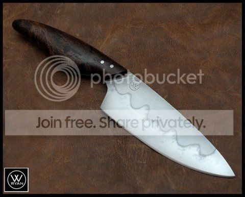

Since I am in full learning mode, how are some guys getting the darker steel with the light hamon with the shorter etch times? Here's a good example.
If you do differential hardening ( yaki-ire) on a shallow hardening steel like W2, 1095, even 10984 ... you will get a pearlite upper and a martensite lower. These etch differently, thus creating the effect.
