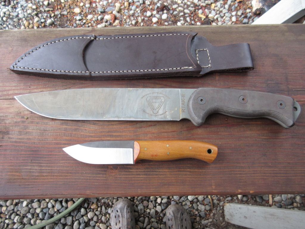

Instead of a machete you could always get a RTAK-11 or Junglas which are big knives. I have the RTAK and it works fine for me, I even baton with it.
Just a thought.
Just a thought.
yes i have the Rtak2, it is a beast of a knife, would work well as a chopper for sure, and is pretty comfortable if you have big hands of course
