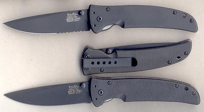

Take a look at a EDI Genesis I style clip - sits real low, but it can make knife hard to grip to pull out quickly (though some guy has demonstrated the quickest draw using the EDI system). Many designs are made for good access/grip: trade offs for stealth, low/deep carry, too

I would like to see "deep pocket" style clips available from Spyderco, as I wouldn't mind paying for them at all. I like your design, Griffon. EDI immediately comes to mind for my favorite deep pocket clip in production right now.

I truly believe the way to make this happen is to take the EDI style of clip and alter it to the Spyderco style of attachment.
Maybe shape it differently, but one turn only.
MDP
Following should be a pic of an EDI clip.
My $0.02

I agree with everyone who's said that 2 180 degree turns are unnecessary. Using three screws like this, they don't need to be all that big, so their profile can be small. Essentially, we are talking about some kind of modification of the EDI clip. As far as low profile carry, I think they have the best solution so far.
