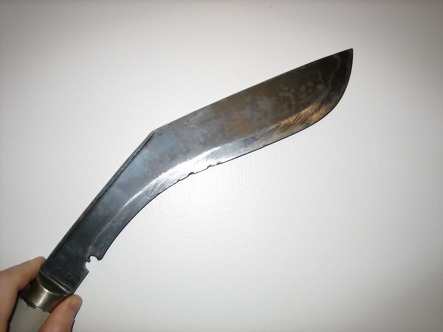

so i took my HI WWII out to butcher a buck I got today, truth be told I haven't used it that much (got lost in a move years ago and I just re-found it).
Anyhow, I lopped off his lower joints to hang and skin him and to my surprise I had 3 or 4 nice almost 1/4'' gouges in the khuk blade edge!
By gouges i mean rounded steel, bent clean over. Is this usual? i feel like this should not be the case, have there ever been issues with improperly hardened blades? last deer i did the same to was with a $9 cold steel machete and I did not notice the same issue...and fwiw its 3mm 1050 series steel with a questionable hardening (made in china i think) before that was a gerber hatchet, again...no issue going through bone.
thanks, i'll post some pictures of the blade.
Bone is very hard. Since you said the steel was bent not chipped, the steel sounds softer than the bone.

that is generally what i do when i dont have a saw or chopper around. i figured the khukri could take it. apparently incorrectly
anyhow, is there a way to rehab the blade to "rebend" the nicks (since it didnt chip out) or do i just resharpen around them and end up with a partially serrated khuk :)

after some reading it looks like a file or stone is the best way to even out the nicks so thats what i did. I'm not here to argue about warranty issues or replacement if the blade is abused but i do have to say its pretty evident that the edge is not all the same hardness. perhaps i dont understand the construction property but my file dug in DEEP along the edge at both 3''-5'' above the handle and at the 2'' of the tip. It skated (as i expected it would) along about 3'' of the belly and barely touched it. I would say that area is clearly much harder than the others (and incidentally not the part that got dented)

I just reshaprened the blade, but now it has a noticeable irregularity in the edge, I would advise trying to flatten the metal back to the edge as much as you can before sharpening
Yes, the recommended procedure is to hammer the fold back into place and the resharpen.
In the case of chipping this isnt possible, but there is usually enough metal to careflly grind it out and put a new edge on.

well, this is the best i could do. i tried to hammer the bends back out with a ball peen on an anvil got some, but some chipped. so I filed it as flat as possible. this actually looks pretty good compared to before i started working on it. =/
as i have said before, i have done this with axes, a tomahawk, and cheap machetes without this happening to the blade. (yes, yes I know axes have much thicker blades but i assure you my hawk and machete do not come close to having the blade thickness this khuk does)
i guess i'm not the only one who thinks the heat treat is not right. anyhow, I understand if you dont want to do anything about it if its against your warranty. wont be buying another though, there are much more durable blades out there - at least moreso than the one I got. It's sad because I really like the idea of the khukri.

i dont have the best knowledge on khukris, but it looks like most the damage was done right outside the sweetspot of the khukri which is got a softer heat treat.
that is true but it bent at the sweet spot as well, not nearly as large but certainly bent. I think that area returned to flat better than the others.
