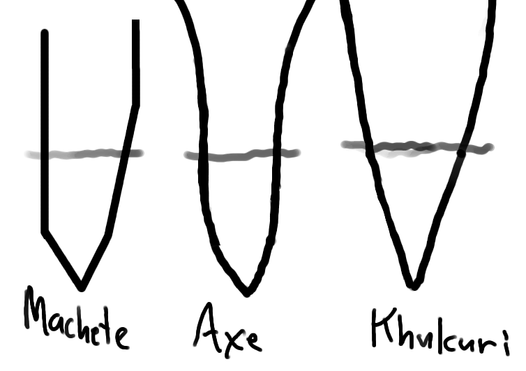

they wern't talking about blade thickness but EDGE thickness, compare the angles of grind, how thick is the khukuri a couple mm from the edge compared to how thick the Machete is a couple mm from the edge, Ill bet that the machete is twice as thick at this point, the WWII is known for having a fine edge
What he said. I did an approximate measurement on my WWII, and the angle of the edge is right around 25 degrees. Not 25 degrees per side, 25 degrees total. In comparison, most machetes and axes will be in the 50 to 60 degree range, most pocket knives 40. 30 degrees is pretty thin by pocket knife standards, more like what you might find on a skinner.
It also looks like the sweet spot is untouched. IIRC, the sweet spot is about 3/4" towards the tip, from that nick on the flat part. A lot of people try to chop too far back, and don't get good performance due to both geometry, and the softer steel right there.

for the sake of anyone reading i took measurements .1'' from the blade with calipers. this khuki .069, hawk, .059, machete .065.
i don't know if you wanted closer to the edge but that's what i had time to do this AM.
i'm not trying to get into an internet argument, just posting what i have found. your experiences may vary.
I'd try closer to the edge. I tried measuring some of my blades around 1/10" to 1/8" from the edge (it was consistent, I just don't know the amount that I consistently measured :p) and got extremely similar numbers. However, unless my eyes deceive me (which is a possibility), the edge cross-sections after 1/10" should look something like this:
