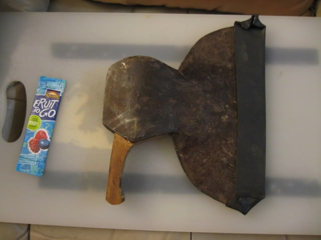

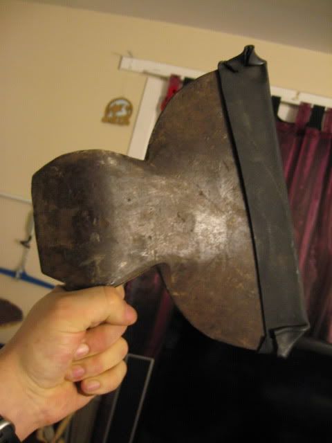

Hello all, I just wanted some advice from those of you more experienced than I. Last year I spent my reading week making this:
for my big baby. This axe is incredible! I have used it for the past 10 years and it makes my woods life much easier (not backpacking though). It has been in Blade Magazine
is better (for me) than a splitting maul, and can shave fuzz sticks better than many knives I have seen people take out camping:

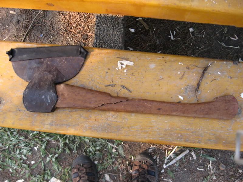

The old handle was getting rough so I thought I would make a new one. With the handle nearing completion I thought I would try it out before final sanding/shaping of the ball/oil. It worked beautifully....
Until this:thumbdn:
No warning, just snap! and a much lighter handle in my hand.

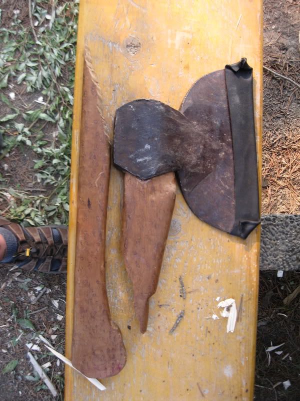

I was warned that this might happen with such figured maple, but the 1" board passed some impacts, I was stubborn, and knew that if it broke I was only out some time and had knife handles that could be worked with the broken pieces.
Reading week is coming, and I would like to redo the handle. Today we went to Windsor Plywood to find some hickory, but they were out, so I picked up some Osage Orange. I know I have seen the Reeves double bit in this wood, and I have heard that it is good for handles, although I did a search and found some had bad luck with it.
If I could get some suggestions about turning it back into a full sized axe with very similar shape to the broken handle, it would be very appreciated. Plus tips on how you would shape the half moon shape to the eye (this is what took all week last time- very slow work). I have never worked with/ utilized osage before, and would like some reassuring that it is a good choice for a 8#, 10 inch bladed axe. (plus how you would finish it to make it look good.

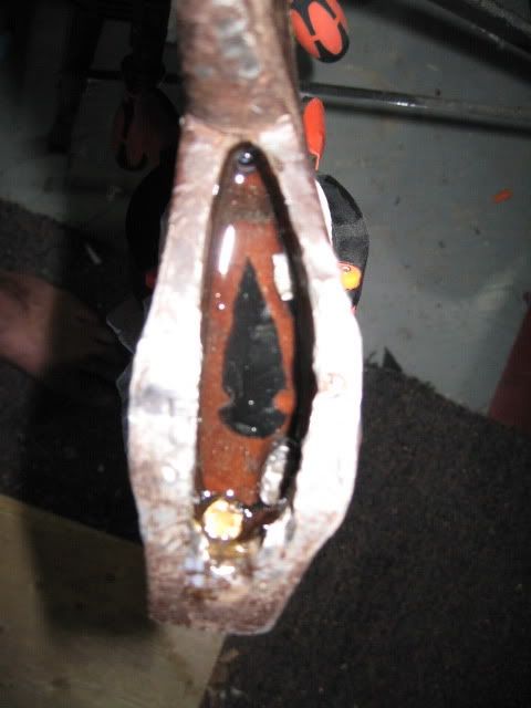

A couple suggestions. If time is a major factor I'd take the head to a hardware store that carries ax handles and get one that is close to what you are looking for and modify it. Just had an idea about getting the shape of the eye. Plug one end of the eye and fill it up with hot wax. After the wax has had time to harden up, pull the plug and warm up the head enough so the wax plug will slip out and use it as a pattern. This works great inside my head. I'd go with hickory if you can find it.
I can't tell from the pictures, but it doesn't look like the grain was running the correct way?

The grain is the proper orientation- I was warned that the eyes would weaken it, I believed to a degree but had to see for myself (I blame my science background).
Ray- thanks for the wax suggestion- I filled the top of the handle with epoxy that was left over (and put a shell and arrowhead into it for decoration).

Hickory would be superior to Ash for your purpose. Hickory has a bit more flex to it and will absorb shock better. The break that you experienced is indicative of maple. Maple is very brittle and should not be used in such a way (obviously). Ash will suffice, but if you are chopping with that axe, the shock of the blows will be transferred to your hands and arms.
Hickory works best. One source that I found, and was very surprised to find, was the bottom panels of crates used to ship MTD brand lawnmowers. Actually, they use both walnut and hickory scraps that probably wouldn't work on other projects. You can find them in scrap piles behind places like Lowes, Home Depot, and farm supply stores. Anyplace that sells lawnmowers. Anyways, they build the bottom panels with 1x2 pieces that are long enough and strong enough for what you want. Not to mention that its free. Most places that have these crates have to pay extra for them to be taken away by whatever trash collection service they have, so anybody who will take them for free is usually welcome to them. You may want to ask first though, just in case.
BTW, that break looks like you were smaking the handle on something. Were you choping and it just broke, or did you hit the handle?

I was just chopping and the handle came apart in my hands- no warning, not a sound from it- and worst of all it was working beautifully- absolutely no negative reverberations or anything. It touched my hands, the knives used to shape it, and the light coat of tung oil to enhance the color. The thing that I have found with the big axes is that they are so heavy (8# head on this guy) that the head absorbs much of the impact. I have had it on longer handles (this will be the 4th handle that has been on it- I have only broke it once) and thought that the 26" OAL was the best for manouverability and power chopping. The free wood would be nice- I'll look in the spring when new mowers come in!
