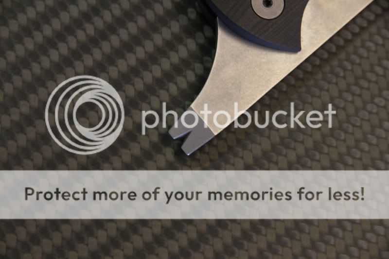

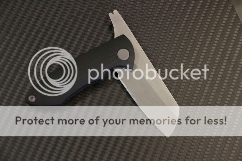

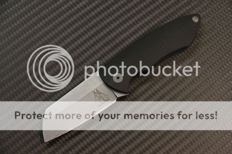

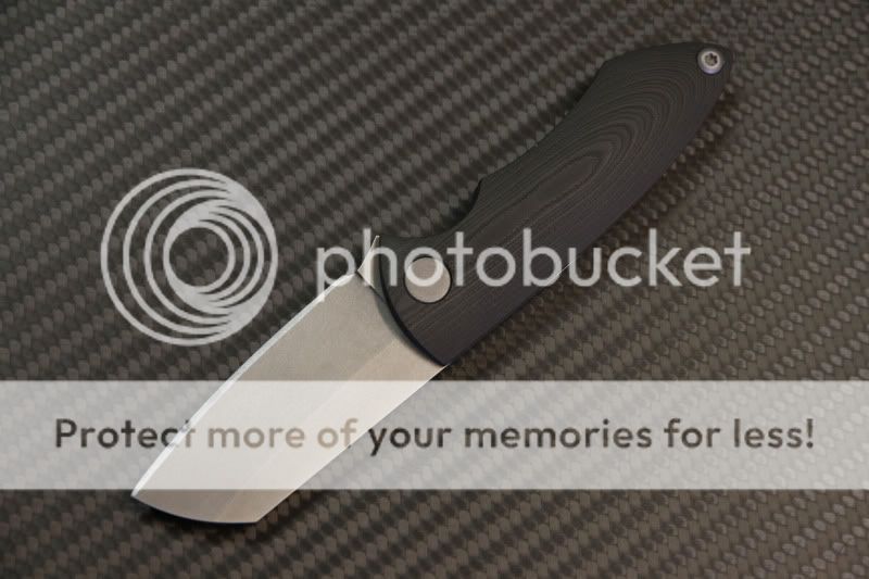

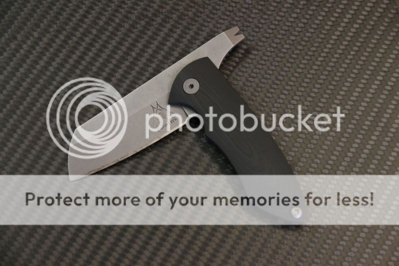

I've always liked the concept of the friction folder, different and simple. One of the things I thought that needed a change/improvement was that little tail off of the back end of the blade. Why not turn it into something, well, useful. So, here it is, the "PryFricky"!

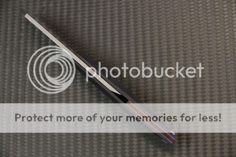

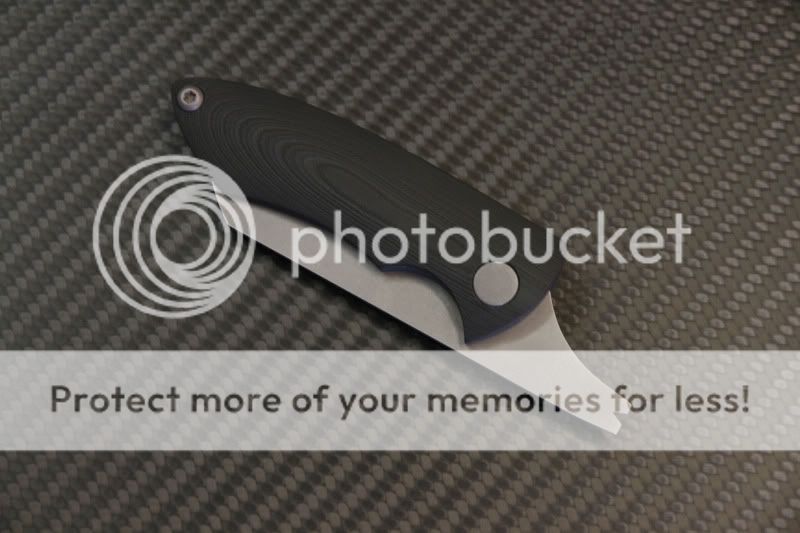

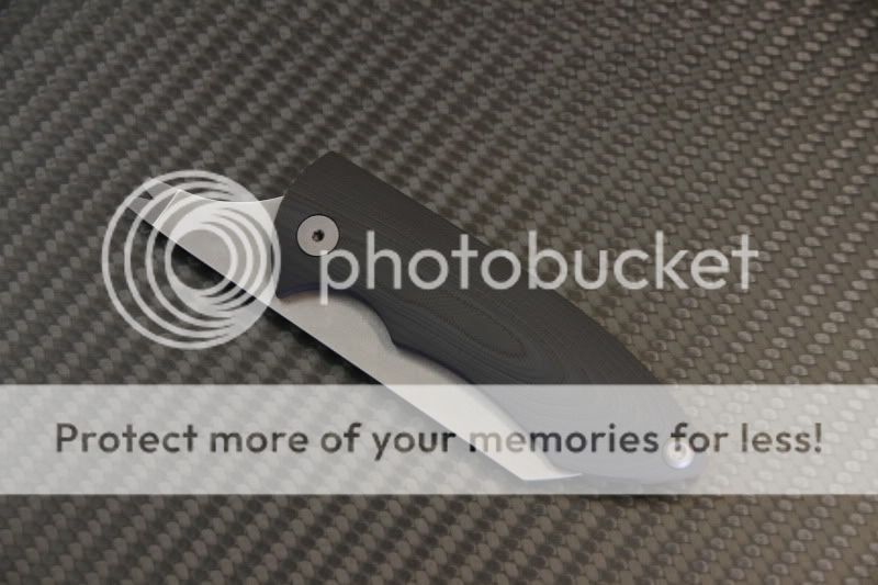

Specs:
Length closed: 5.79"
Length open: 7.45"
Blade length: 3.0"
Handle length: 4.45"
Blade thickness: .1290"
Pivot: .250"
Weight: 4.4 oz
Steel: CPM154

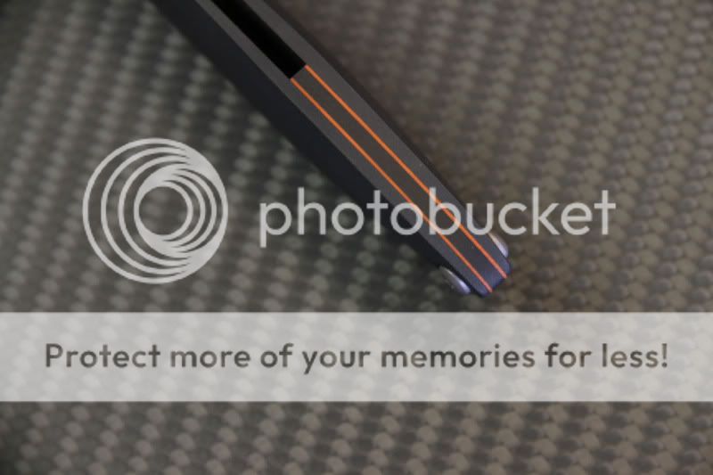

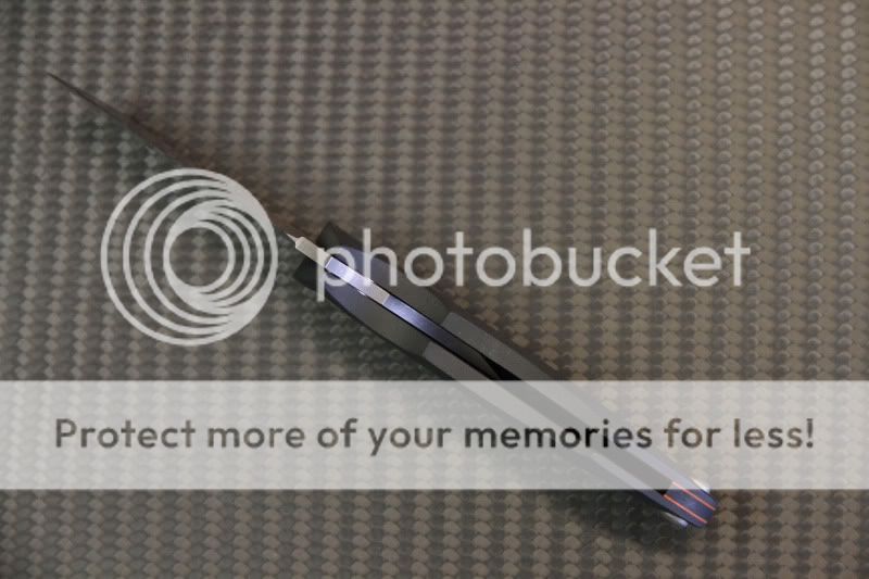

Handle material: B;ack G10
Back spacer: Black and orange G10
Washer material: Phosphor bronze
this is very nice ,love it ,,great idea on the pry on the end !!

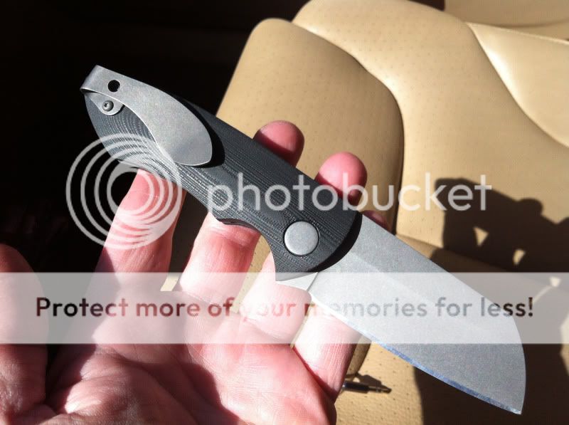

I threw a pocket clip on it the other day. It rides any other folder in the pocket, I can't tell its got a pokey thing on the end.
