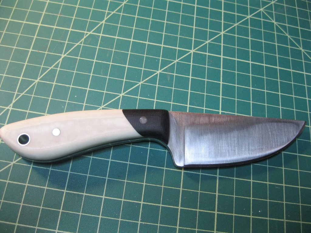

I finished my second knife, I sure learned a lot.
Feb 23, 2010
1,497

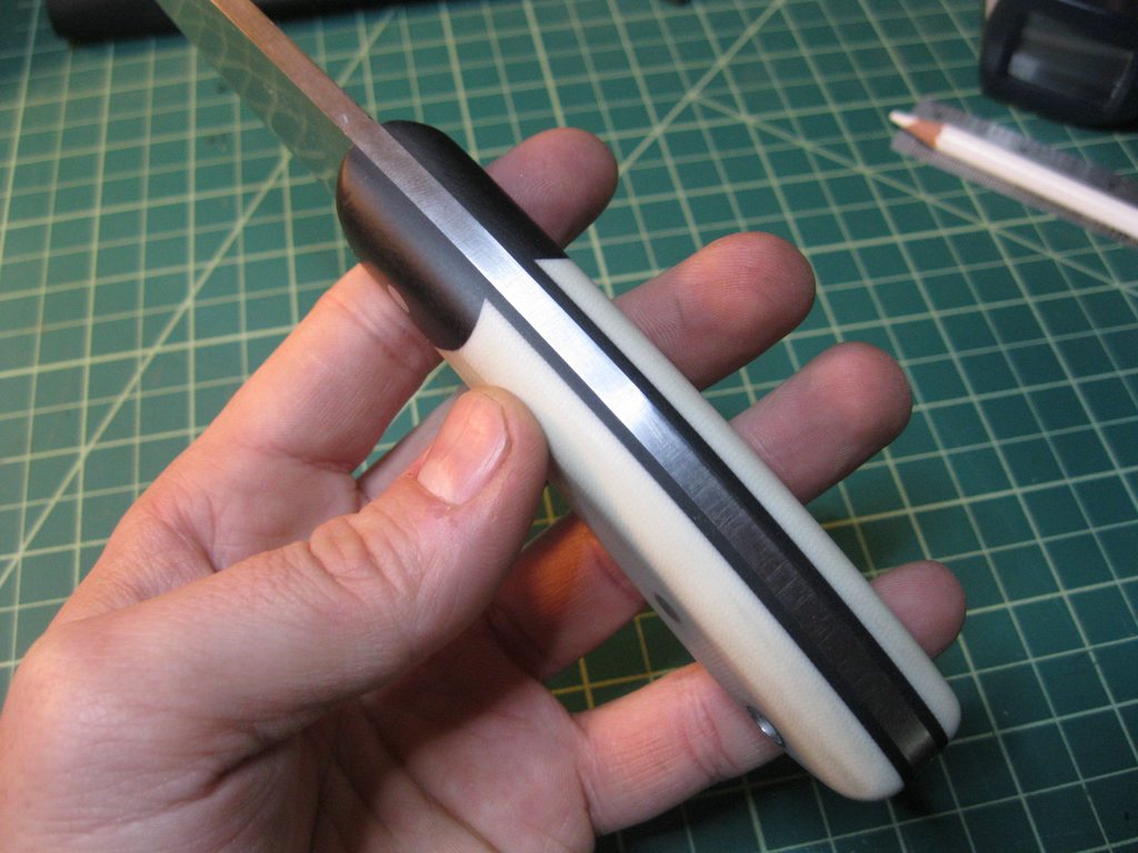

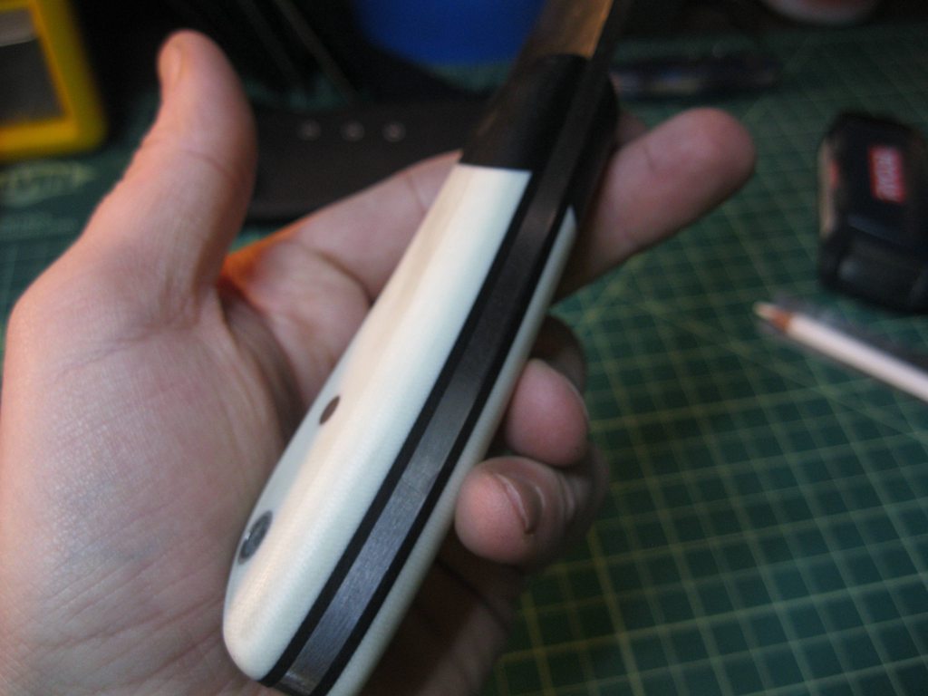

I often feel like I don't have enough shop time, but I did finish this one up. It still need a Kydex sheath, its shaving sharp but it still needs a mirror edge. I didn't bother polishing all the grind lines out since its 1084 high carbon and will patina with use no matter what. Pins and lanyard hole are stainless, black G10 liners, with white and black G10 handle, and the edge is convexed.

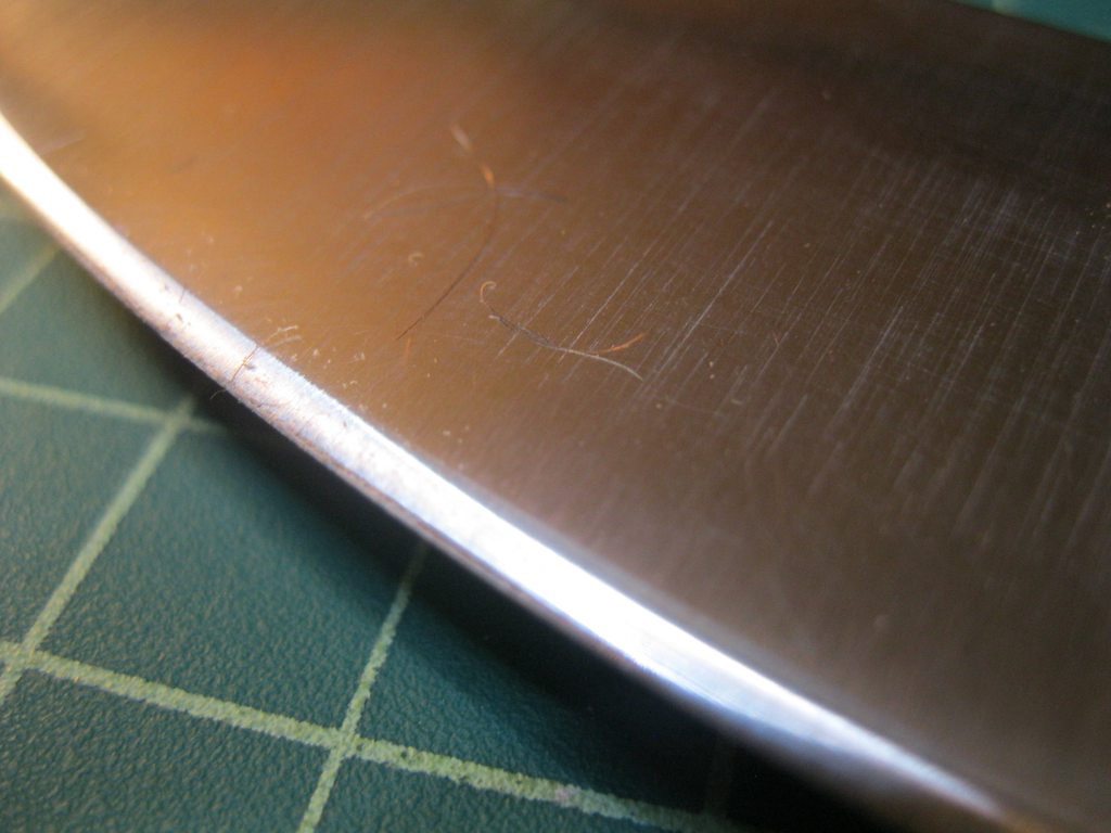

It's far from perfect in my opinion, I made some mistakes on it like the fact I spent to much time at lower grits I feel like and left some deep gouges in it the blade that would be to hard to work out and I also put a little ding in the corner of the spine near the handle.
I know I need to work on my blade finish but other then that I would love some advice on improvements I could make for the next one.

I am kind of wondering what grit to start at I have been starting with 36 but maybe it to aggressive?
I'm still very much a noob so I have a lot to learn about how and where to start. I am still working with a HF 1X30 sander and the most aggressive belts I have right now are 80 grit. For me that seems to work ok. Keeps me from over grinding too fast. I still haven't made a knife worth showing the finished product yet. But I'm getting there.
Very nice job! I like the way you did the handle. The whole knife looks good but I really like the handle.

I usually don't go as low as 36 -- 80, or even 120 if that's what's already on. I used to do a lot of fiberglass and epoxy work on boats, and found that it didn't take that much more time with a finer grit and I was less likely to make big mistakes. But to each their own, you'll find the way that fits you.

Hogging off steel at 120 is a different monster than wood or fibeglass at 120. 36, 60 or 80 sure speeds things up.

Keep in mind a high polish on carbon steel is one of the best ways to resist rust.
As far as 'other improvements', I dont see any issues... your handle fit and finish is great. I'm not normally a fan of white on a knife handle, but dang, you certainly made it work.

Its not about what grit you start with as much as it is knowing where to stop using that grit.

That's a beauty, really like the blended handle

Let me begin by saying that is a super looking knife in almost all respects. The only thing that lets it down is the finish. The problem isn't the grit you started with, it's the grit at which you finished. It has been discussed in other threads but this is just another example of the great early work being turned out by new makers. The new guys (like me) have so much information at their disposal and so many talented makers who have come before them laying out the footsteps to success so us new guys can avoid much of the frustration and wasted time of figuring it out for ourselves. You realize already that the finish could have been much nicer. I put aside a knife I'm making for a few months because I really wanted to do my best with it but I wasn't ready to wrap my head around the work it involved. Well you can't finish if you don't start. So I began the work and I'm almost done now. I'm glad I waited until I was ready because the product will be worth it. Yes, even a well sanded blade will patina but that's no reason not to do the work. Maybe you just weren't ready. It is clear that you have a good eye and sense of design. Your product is worth the effort.

The handle is great - you nailed it!
The bad news is the blade isn't finished being finished.
The good news is there's still a TON of steel left on that blade. Go back with a new 60 or 80 grit belt and grind it down even thinner. Be careful not to overheat it, make sure you dip in cool water often, and take a bunch of steel off. You could make that blade a whole lot thinner before you weaken it, and it'll slice like a fiend with better geometry. I'd go 80 grit, 120, 220 and 400. Leave it with a machine finish, don't bother trying to make the grinding marks go with the blade. Just make sure that the grit progression eliminates the marks from the previous grit. A nice 400 grit finish that's consistent across the blade will still look nice!
I know this sounds nuts - I had to be dared to grind my blades thin. Now my THICK knives are below .020" where your edge bevel is!
I double dog dare you. Try it! You'll be stunned at how much nicer the blade cuts, AND you'll be fixing your finish faux pas!
