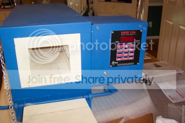

I got a new toy :D +stainless steel ?'s

I figure this is a step up from my brick forges. :cool:

Is this the right socket? My dad said is was 240v.
Yep that a 200v plug but check and see if you have 100v per leg witha meter.Nice score on the kiln, also I am sold on the CPM 154CM.
i think thats 240
i think they were for air conditioner, a small window one.
it looks like it has small romax wiring so someone might have use it for 110
ask jt he's on here , and thats his type of work. after i'm just a bricklayer
vern
This socket powered a large (6' tall or so) stationary air compressor, and has its own breaker box... if that helps.
Yep, standard NEMA 3 prong 20 amp 240 VAC outlet. If properly installed it will have at least 12 AWG wire and a 20 amp 2 pole breaker.
You should read 110-120 volts AC between either of the flat prongs and the 'D' shaped ground plug, and 220-240 VAC between the flat prongs.
https://www.hubbellnet.com/max_htm/tech_stuff/NEMA/front.html
I'm an EE by education, but end up doing a lot of 1 and 3 phase power work as well.
yep its 240. that looks like the old romex 12awg wire. now all 12awg romex wire is yellow. your going to have to find a way to mount your kiln upside down as your plug is :).
Different plug configurations are for different amperages as well as different voltages. That one looks like a 220 plug for a 20 Amp circuit.
Question: how many amps does your oven pull at 220V?
You should find the info on the maker plate, usually a silver plate on the back of the unit. Sometimes it is given in wattage. Divide the wattage by the voltage to get the amperage. (I'd be somewhat surprised if you only needed a 20 amp line for that. )
IF your furnace takes 30A and you try to run it on a 20A, you will blow the breaker. Breaker amperage is determined by the diameter of the wire. So if you have a 20 amp circuit and you need a 30 Amp circuit, you will need to run new wire to the breaker box. For a 30 amp circuit, you will need #10 wire. For 40 amp circuit, you need #8.
cool! then looks like you are set to go.
