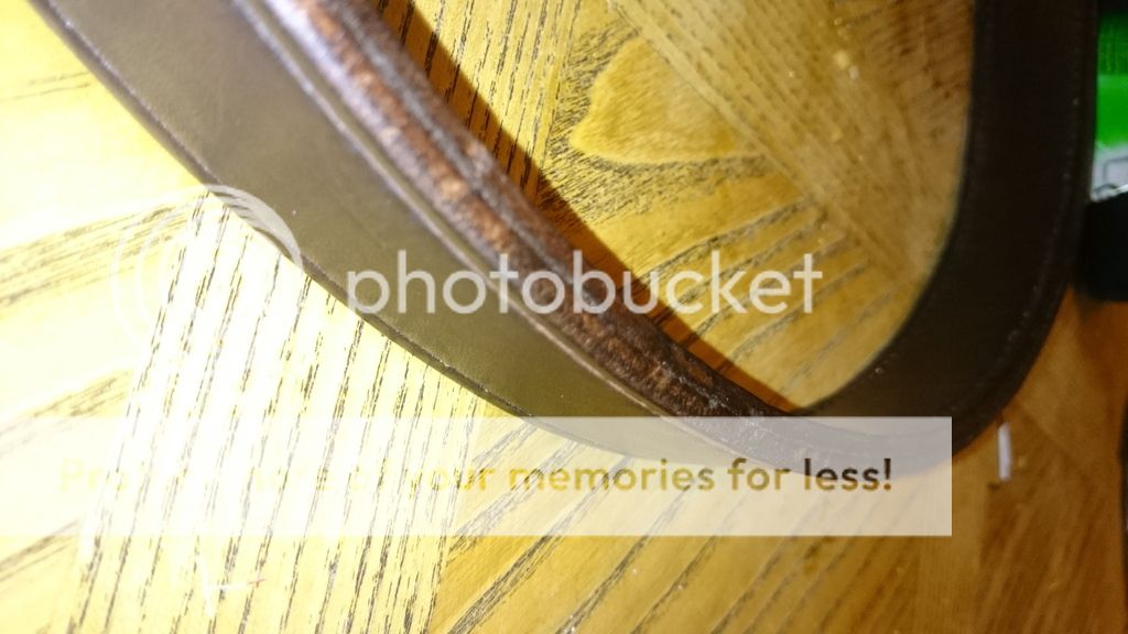

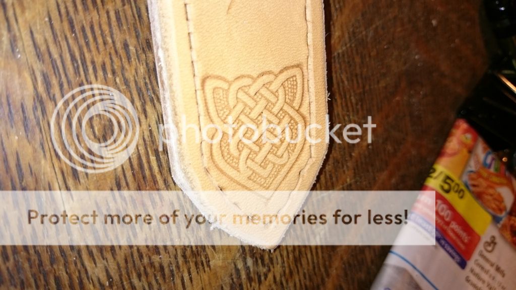

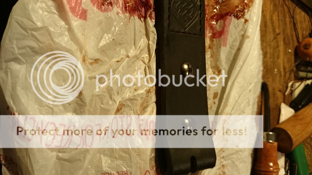

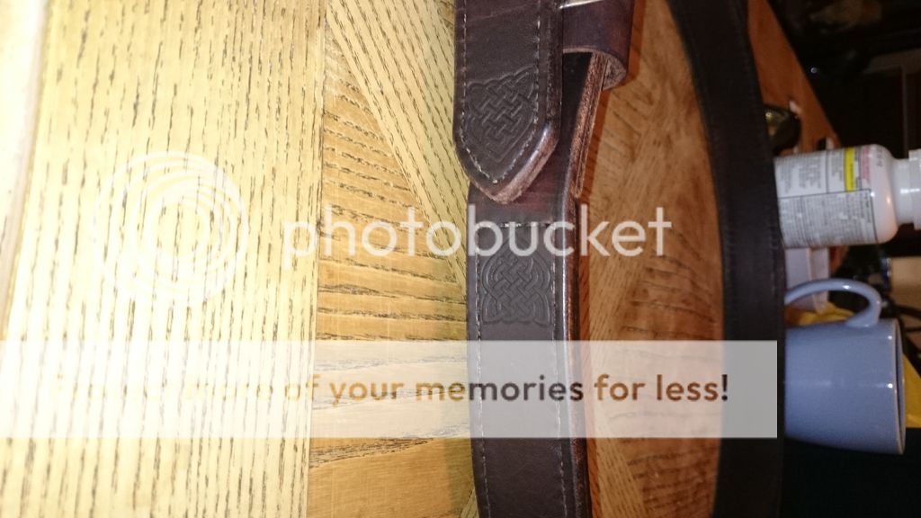

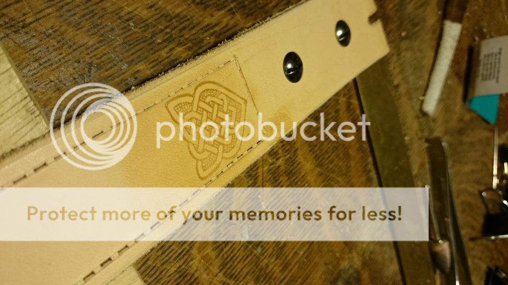

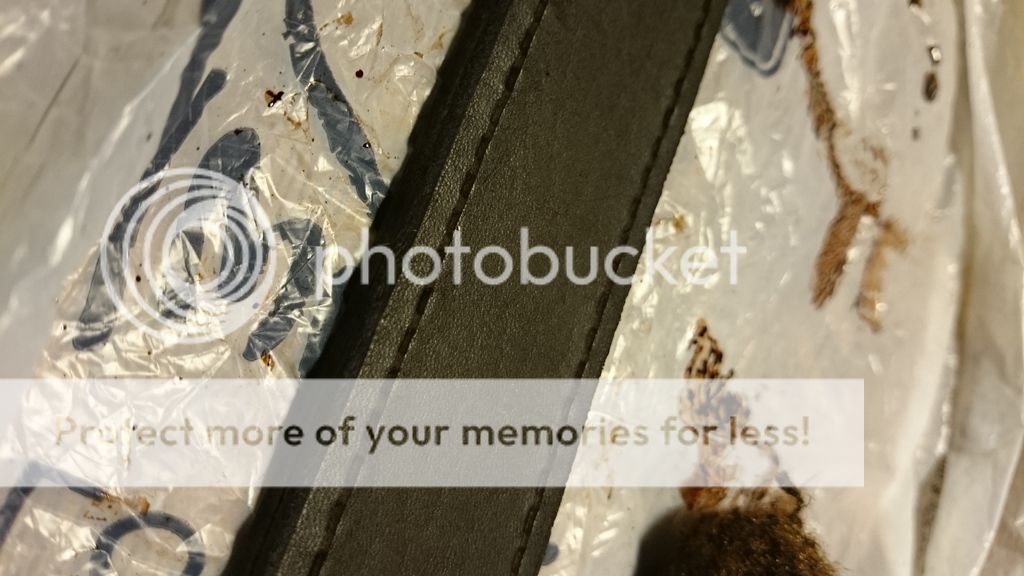

Got somewhat of an itch this week and can't shake it, no matter HOW many projects I do.......
Double thick belt so my holster doesn't distort it from weight...
Got two cow hide strips from Tandy. The rest of the supplies I had:
Fiebings Dark brown Oil Dye - 3 oz used
1/8" gun metal colored, open back Chicago screws x 2
Celtic Shield Knot stamp
Tarred Bank line as thread
waterproofing agent - My beeswax+Boiled Linseed Oil+turpentine recipe.
...over 10 hours work, 3 band-aids, 2 pots coffee, 1/2 pack of smokes, 3 lippers of Skoal long cut mint and one wife whining about the dye smell....
I think it turned out well
Looks great. The stamp work is a nice little touch to give it some character. Is that the first time doing a belt with the two layers like that?

Thanks. Yes, that's the first time making a belt at all. I've made quite a few sheaths, axe masks and a couple of holsters but never a belt until now.

I started doing my hand stitching while wearing a pair of latex coated work gloves(couple bucks a pair at HF). The rubberized grip helps pull the needle through and then also doubles as a cushion for my fingers when I pull the stitch tight.

yeah it is...lol. If I had the time I might actually get a stitch count............but there are just so many...........LOL

Standard size is a 38", which would usually be around a 45.5" strap with 3.5" on the chape (fold over). at 7 stitches per inch, times two, your looking at roughly 600 stitches....and to think I get frustrated at how 'slow' my machine is some days :cool:

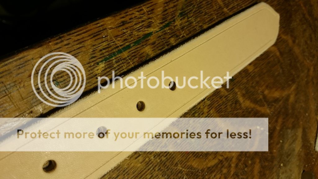

I like your belt. One thing you may consider is waiting to punch the holes until your finished. Sizing the belt is always the very last thing I do on a totally assembled belt. Lot of room for variation when you pre-punch the holes and especially on personal gear you can put it on to punch that 'perfect' custom fit. Everyone handles this differently just a thought.
Yeah....however many stitches it was....took 6 hrs by hand. LOL.
On the holes punched...I used the belt I'm currently wearing...which is about 15 years old and perfectly fit. I marked the existing holes because the fit was so good but I appreciate the thoughts.
