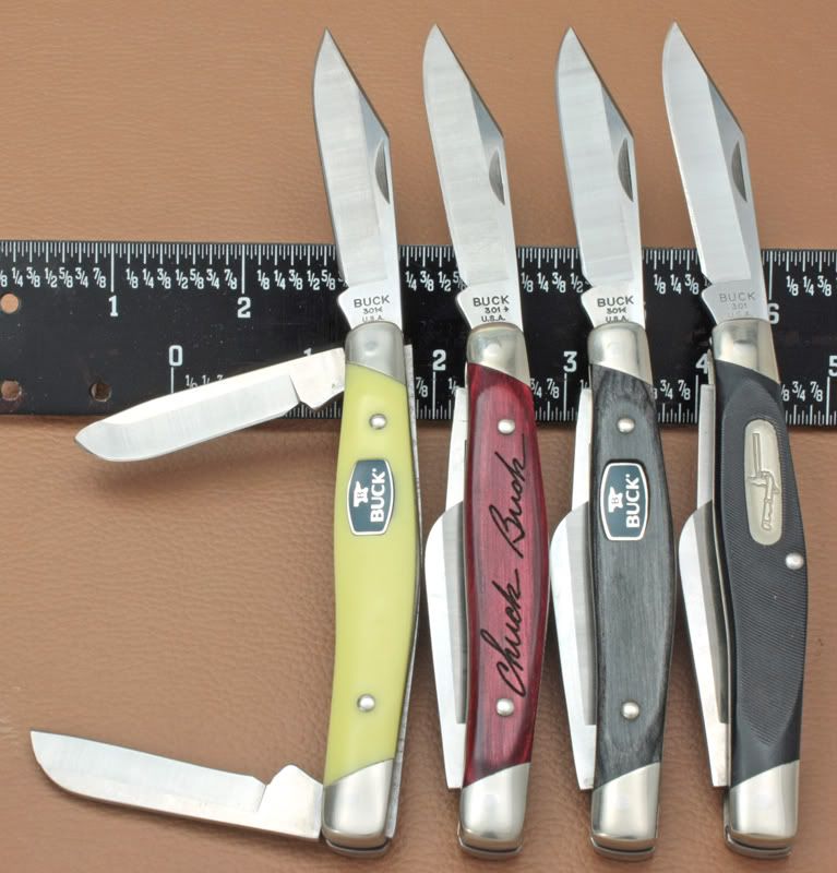

All the knives mentioned here are all great knives, I have been to A.G.Russells, about an hour away, any that strike your fancy would be good. I collect old Buck slipjoints so here is my fair and honest evaluation for your knowledge.
Buck knives are likely thought of as a tough every day carry sort of production knife. But, sometimes one with fancy scales and high polish will be offered. The 420HC steel is considered to be decent quality and there heat treatment was designed by the best, knives usually come sharp as a tack, Bucks lifetime warranty sets the bar for everyone else to equal. You hear several stories of fathers and grandfathers carrying a Buck stockman for many years. They offer 'SPA" treatments for old knives that will make them gleam. You won't see much premium steel or art deco scales. Most slipjoints are made all stainless with a spring for each blade. The symbol after the model number on a blade is a date code. The old black delrin sawcut scale was the standard but new slipjoints come in other scale types. The large Model 110 lockback got the Buck line going. Thats the run down, you can find out the same info on other brands by going to their websites and doing searches here on the forum.
As always unless you live in the sticks, going to a knife 'rich' store and handling many of these brands would be the best way to begin. Nothing equals feeling the spirit of the knife in hand.
My current 'attraction' is the yellow valox scaled stockman. I guess I have always had an attraction to blondes.....(MMs fault) 300Bucks
