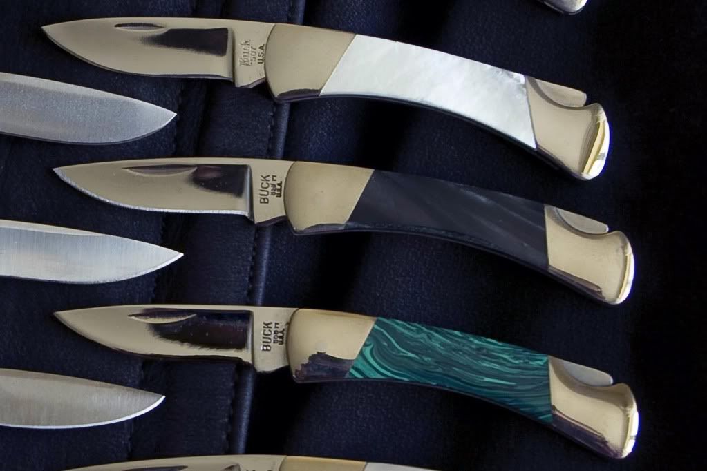

Thanks guys, I wasn't sure about the Ultima... Because I have this Pearl handle 501 that I got from ex-employee... So what is this one a Custom??? :)

501 Pearl... Click on pics twice...

I would say the 501 is a custom. The Steeplechase and Palmetto Cuttlery Club pearl 501 knives had satin blades so their overruns would also have been satin. The script three line tang stamp would indicate that the blade was probably polished at the factory, possibly taken from a batch of polished blades made for the Aurum game scene knives or the Grand Slam knives, since you got the knife from an ex-employee.
Or is the black pearl the Ultima II?
Haebbie
