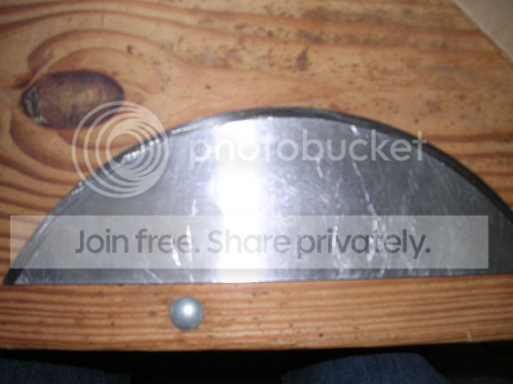

I have this odd piece of A2
As the title says, I have this
piece of A2, it is roughly 9" stem to stern and 3/16" thick. I was wondering what type of knife would best take advantage of this piece.
Any feedback appreciated.
Thanks for looking!
Yes a large ulu for cutting up your elephant !! Or put a handle on each end for an Italian 'mezza-luna' [half moon veggie chopper].

I believe you could swing a hunter out of that, no problem. Of course there will be some waste. If you're looking to use all of the steel, then an ulu would be a great choice.
I like the idea of making several pie-piece shaped cuts and making hawk heads. That would be my choice.
You could also try and make a small full-tang hawk from it, but the head would be small.
Do a lay out on paper , draw some up papers cheap ,keeping in mind the 3/16 as to what it will be for..you should be able to do more then 1 at 9 inches long looks like theres enough ...

1) that will easily make a serious 3-4" outdoors knife if laid out properly. Grind it high and flat so you can get a decent edge and lose some weight.
2) If you like stick tangs you'll have more layout options as less handle will be required

Its a little wide for a head (round ) knife as used in leather working. You could if adding a tang to it make to half round leather cutting knives out of it or cut it down a bit and make one bigger one which would be great for skiving. Ofcourse 3/16 is a little thick for that application so you would be removing some metal.
