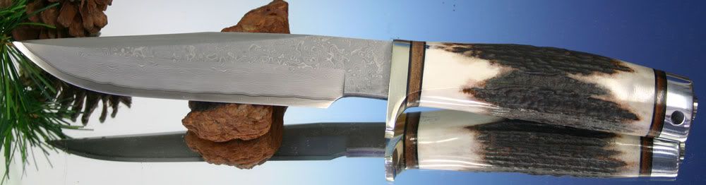

I have a Cowry X Damascus knife whose profile strongly resembles a Randall Model 5-5, but with a convex grind. I have two problems with the handle: the stag handle is too large [too wide or thick]; the end nut protrudes from end cap.
1. How do I reduce the stag handle's thickness about 3 mm per side without otherwise harming the stag?
2. I don't have a decent graphic of the end nut-end cap. However, it closely resembles a standard Randall in protrusion. Flat-ended end nut is threaded onto tang. End nut appears to be capable of being tightened/loosened by way of a two-pronged screwdriver.
Were I to remove the end nut and counter bore the end cap, I would still have tang protruding. What do I do. OR whom can you recommend to fix these problems?
I can't speak for other guys but in my own experiences working with stag unless you know the specifics of how it was bleached and polished to begin with it will be very hard to selectively buff on one spot without it standing out as different compared to the rest of the finish. You can certainly take it down 3mm but be aware that in doing that you will most likely have to refinish the entire handle so it all matches after you get it to where you want it.
Its also quite easy to burn mark stag if you are not careful when buffing it. Unless you want to do that on purpose I'd avoid keeping it on the same spot for too long when you are doing the buffing. Keep it light and keep it moving to avoid lettting it heat up.

I would contact the maker and ask if he can do the work you described.
That's a great knife. Can you please email me the maker and the price?

Take off too much and you'll be down to the pith of the stag. That is the porus center of the antler & that is not attractive at all.
Again, only my opinion, if it were mine I'd leave it alone.
Just received a reply from Mr. Iwahara. Problem is solved. I send the knife back to Kencrest. Iwahara will arrange for Hattori to adjust when he returns from Blade Show in Atlanta the third week in June.
