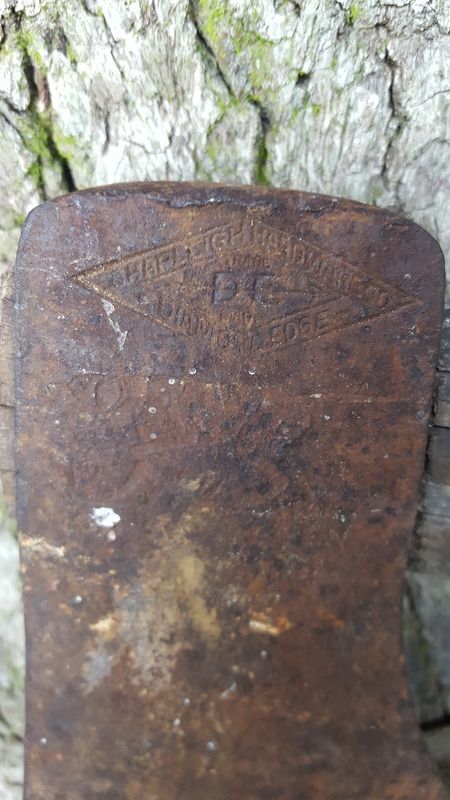

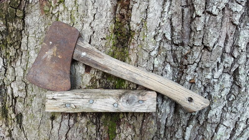

So a couple years ago my great uncle Bill passed. He was a master carpenter. While a few family vultures picked over the majority of his life for valuables, I walked around in his workshop. Scraps of exotic wood, long rotted with age, old tools and spider after spider. I found an old hatchet in the rubble and decided to try and revive it. I'm about to become part owner of the family property that my great uncle and grandfather worked their entire lives- that means a much more hands on role and a good hatchet will be indispensable. So I want to breathe a little life into this old thing and get to work.
Enough of my rambling, on to the hatchet. The head is stamped: Shapleigh Hardware Co, Diamond Edge, inside a diamond. There is another logo under that but it's obscured by built up rust. It looks like the rust isn't quite bad enough to cause major pitting, but I won't really know until I get the rust off. So that brings me to my first question. How do I remove the rust without destroying the logo? I've heard of vinegar baths, I have some white vinegar, is that appropriate? I have sandpaper and stuff but really want to save that logo. It doesn't look very deep in. The haft is gone. Brittle, cracked and loose.

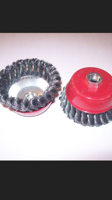

That's a great looking hatchet and a cool story! I've had best success preserving logos and such use a wire wheel attachment on a angle grinder.

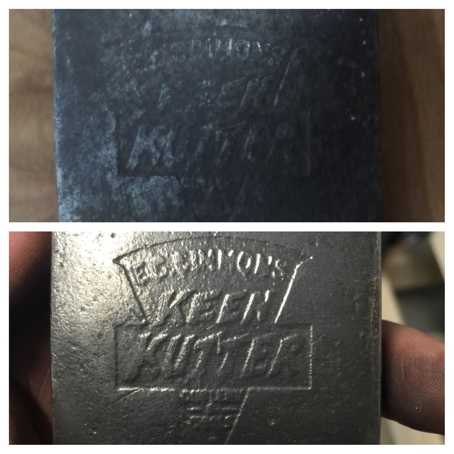

I tried the vinegar bath and it was dirty and tough. I much preferred the wire wheel. Below is a picture of the type of wheel I mean and a before and after.
I can only give you the assurance of my experience- I've had success on about 6 different heads.
I'm sure a similar crimped wire cup on a drill would produce a similar result.
Good luck and please do post pictures!
Oh nice. Ok, that's a different type of wire brush than I was picturing when I heard of people using them. Makes much more sense now. I'll grab one of those and get to work on this thing tomorrow! Pics will follow with progress.
Sounds great! Just make sure the head is secure so it doesn't go flying if you catch a corner! Be careful and good luck. I clamped mine In a leather lined vice.

A knotted wire cup brush on an angle grinder is a super way to clean rust off old axes. Also consider using a brass wire cup brush. They take a little longer but are still very fast and leave a little nicer patina.

...The head is stamped: Shapleigh Hardware Co, Diamond Edge, inside a diamond. There is another logo under that but it's obscured by built up rust...

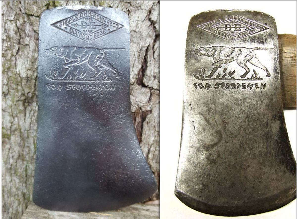

Below the Diamond Edge stamp is an embossed dog, similar to this one:
A nice hatchet! Supposedly made by Plumb, according to YesteryearsTools and other sources.
Nice work Steve. I couldn't make out the dog but it's so obvious now after your post. Pics make it hard to tell the size but it looks to me like a longer handle would be appropriate too. Congrats on that find - it looks dang near complete to me. You can bet that's gonna be a good one and comes with good memories.
To me the dog looks the exact same, but I may be wrong.

Didn't have to cut it, slid right out. Pretty sure it's junk. Several cracks and it's misiing pieces to where it doesn't fill the eye front to back.

Well, here she is after some time with the wire wheel:
Logo looks good and the patina under all that rust is awesome. I might have been a little heavy handed in a couple spots here and there, but overall I'm happy with it. I also went after the mushrooming a little bit with a hammer. It looks bad in the pic but in person it's much cleaner than it was before. The hammer took the patina off but once it starts coloring again I think it will look much better.
Take a closer look. This axe on the left, the one Steve posted on the right.
Note that on the left axe the dog's forehead drops down to the nose at a steeper angle. Also notice that the ear is down instead of back. Then look at the jawline.
As Steve noted, they are similar but each is distinct.
