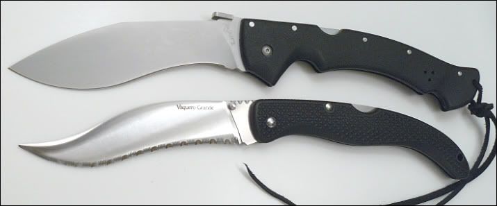

When the Rajah II first appeared, people who saw it reacted very favorably to its size and strength. The YouTube video also gave it a boost, and though it's an impressive knife, don't forget that as far as size, it hardly dwarfs the Voyager X2 and the Vaquero Grande, both of which are incredible folders. The Rajah II is a more substantial knife (heavier and stronger), but the Voyager and Vaquero are both exceptionally strong folders for more conventional carry. Neither will hold up for extended chopping, but they make excellent self defense and outdoor knives.
The Rajah II (top) and the Vaquero Grande, two very large
folders. Why don't other knife companies offer competitive
sizes and types of their own?
The Rajah II is certainly heavier and a better chopper than the Vaquero and X2---but all of them are excellent, and certainly do have their uses! :thumbup:

Thanks for the side-by-side of the Rajah II and Vaquero Grande. Allow me to say: :eek:
