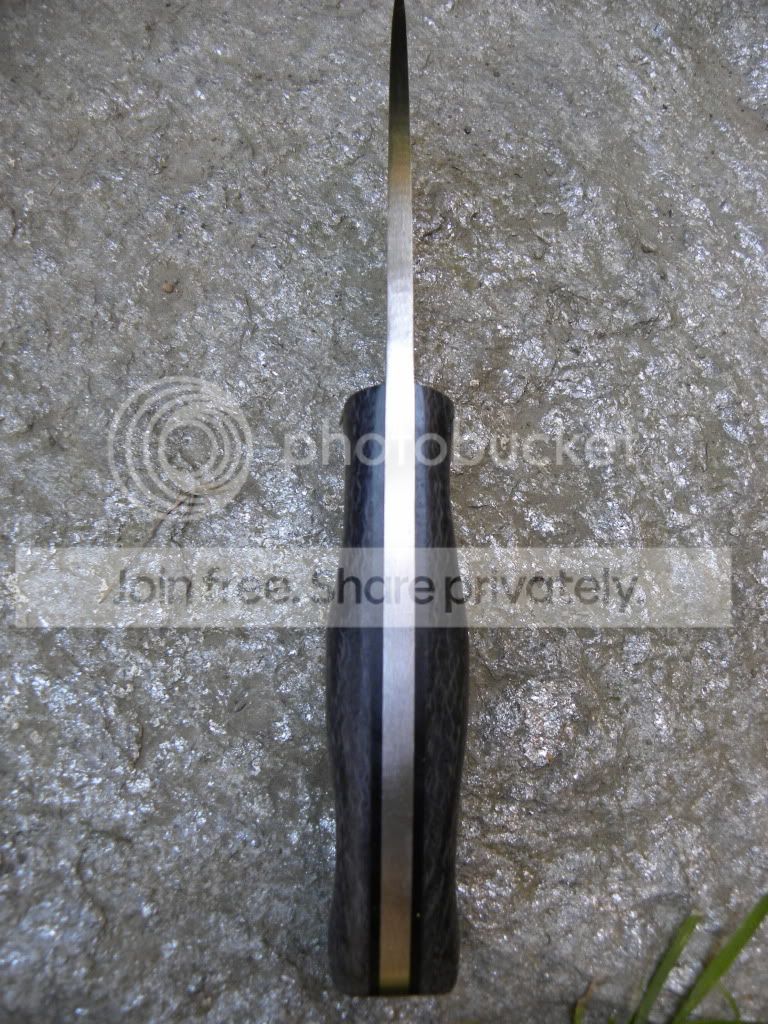

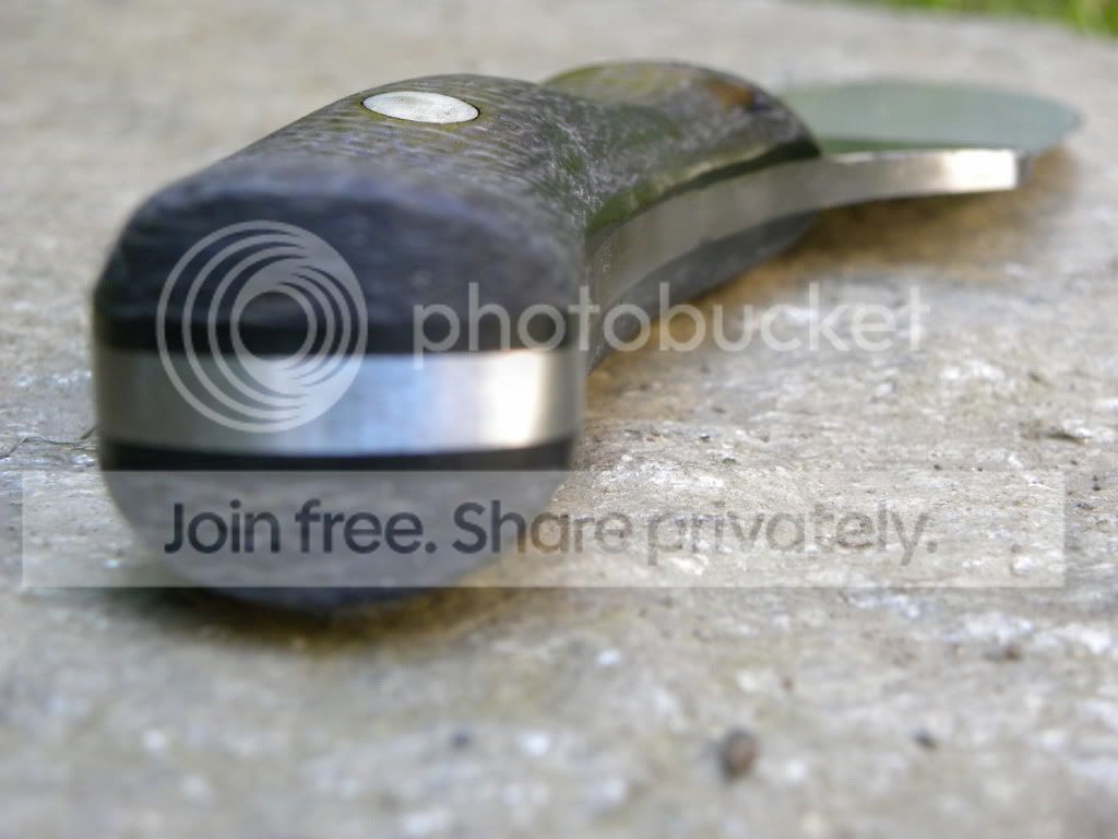

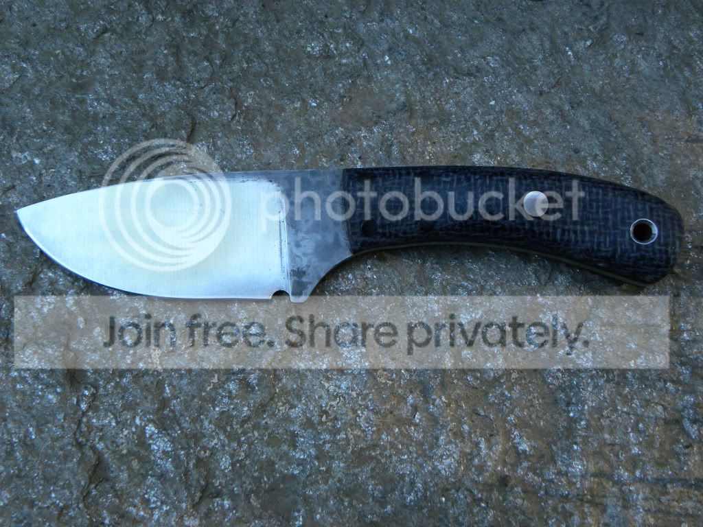

I just finished this big ugly skinner for a friend. This one is number 7. It's Aldo's 1084. It has a 3-1/4" blade, 4-3/8" handle with an overall length of 8". The scales are Suntree's Black and white burlap over G10 liners.
As I was finishing the handles, I kept dunking it in the water to keep the stainless rod and corbie cool. I was doing everything I could to prevent another knockdown, drag out fight with that damn corbie bolt. This was going on for awhile as I was really focused on the shape. Then I noticed that I had gotten it so wet that I was removing chunks. You can see a few spots around the micarta rods towards the front. It's look like hell. I don't have any black epoxy or pigment. My question is what would you use to fill those small voids? Black wood putty?
That's kind of where I am. I know it was something I was doing. If it wasn't the water, then maybe I was running the grinder too fast? Which is another problem since I use a Craftsman and it's only one speed. I was going from the grinder, to files, to a sanding drum. And it was really wet. It had a different feel to it. Somewhere along the line I did something wrong.
What happened with the previous Corby bolt you mentioned? What are you using to shape the handle that it is heating things up so badly that you need to dunk it in water? and how did the dunking in water create holes in the scales?... I know more questions than answers. I am having a hard time seeing holes in your photos.
The handle shape looks really comfy. Typically when I find "Small" Voids in handles I use CA, the clearness takes on the scale color as long as the voids are "Small" as you state.
The burlap might have absorbed water and expanded enough to over stress the resin. You can mix powdered graphite with epoxy to get a black. You can also try a clear substance like super glue to fill the holes.

It was the file I was using. I went into the garage and took one of the pieces I cut off and went through everything I did on the scales. The file I was using was too aggressive and dull and it's pulling off chunks. Another lesson learned.
I'm pleased with the handle contours. The grind is thin and contoured and is very sharp, but I still need to work on my plunge. I am still unable to achieve that nice circular look from the grind to the plunge.
Good looking knife! Depending on the size of the missing chunks,you may be able to super glue micarta dust into it and at least hide it.
Only time I have seen something like that is when I over-flared a tube fastener and it blew epoxy out of the G10 scale. Did it only happen around the pin hole(s) or on other spots on the grip?
Justin, that's exactly where it happened. I took the pieces I had left over in the garage and kept trying to reproduce it. I drilled a hole and jammed a piece of micarta rod and there and put in on the grinder. Nothing. Then as I went over it with that old file, it yanked a chunk right off the edge of the hole, and looked exactly like what I had on my scales. Once again, I just need to slow down and take it easy.
I mixed up some epoxy and graphite and filled the small holes. The guy who I'm giving it to loves it, and I learned some more, so I guess thats all that matters.
