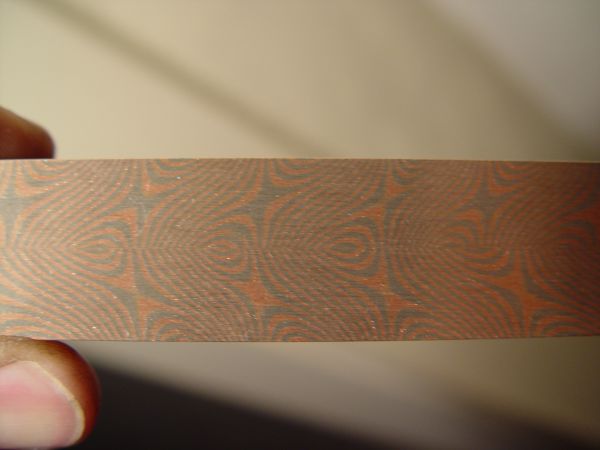

Here is some that I made for the collaboration knife:
Loredo7mm IS the man. He is our residing mokume master in my opinion. I have seen his work up close and in fact have worked some of his mokume. You will do well to speak with him about it.

Thanks Laredo
That answered alot. I like the looks of the piece in the pics too.
