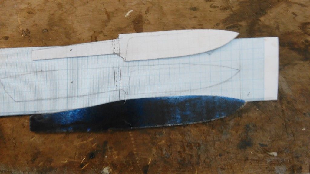

Pencil and paper for me to.
Tried those french curves for a while but they don't work for me.
I like this checkered paper. If I have a drawing I like I photocopy it and glue it on to thin plastic so it is thick and sturdy enoug that I can scratch a line around it on my steel
