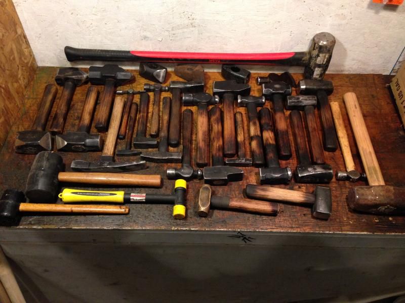

Im in the initial stages of hammer addiction I think. I've been piecing together my blacksmithing/forging supplies lately and after getting my first anvil the other day I decided to get my hammers together(that I've been getting from estate sales throughout the years). I dressed my first one last night, a 2.5lb cross peen.

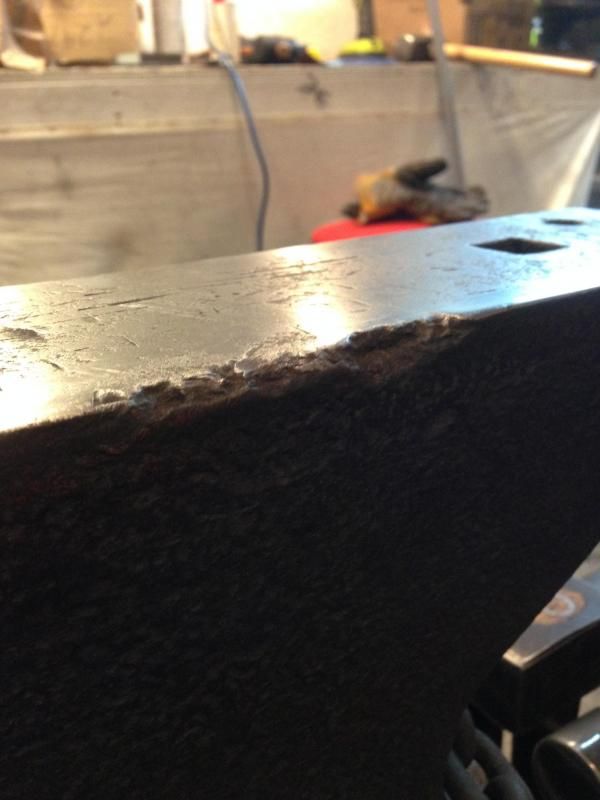

I just picked up a new(to me) shop anvil. It is a Vulcan(Arm and Hammer) in decent shape. I think the top plate has been machined. It is only a 1/4" or so thick. It has some nicks and dings but is flat, overall with no saddling or cupping. There was a 3" long chip(1/4" deep) on one edge that I rounded off to 1/2" radius because I just couldn't stand looking at it.

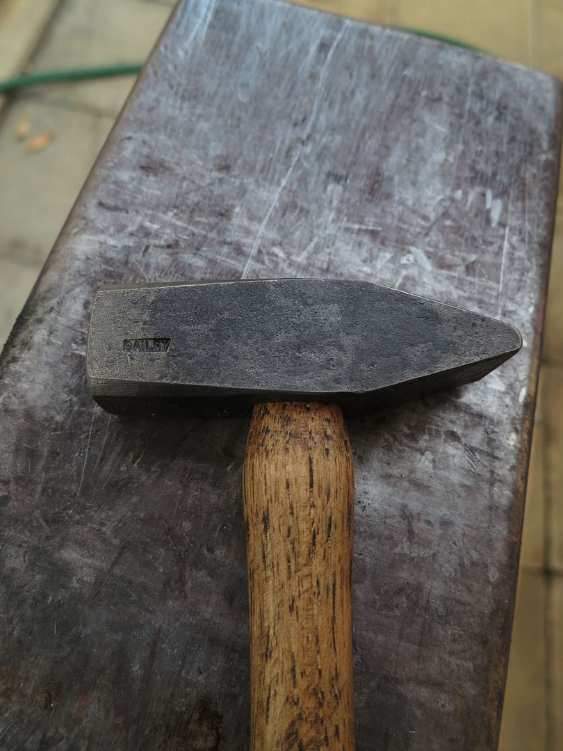

Here's the second hammer I made, haven't even had a chance to try it out. Weights in rite at 2.5 pounds and is just a simple rounding hammer for blacksmithing, forged from 1045. Will most likely be doing a couple more like this, one larger and one smaller, if I can find the time.

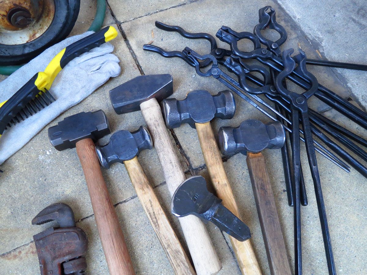

I've been watching Ed Caffrey's Bladesmithing video and he has a real cool looking hammer. It's a diagonal peen. The peen runs from probably 11 o'clock to 5 o'clock. When he holds the work it lines up perfectly for drawing without having to contort your stance. I'm thinking about making one.
I've got 5 diagonal peens in my first photo. I only use one, now(it doesn't have a handle in the pic). It is a RH/LH double sided diagonal peen and weighs about 3lbs.

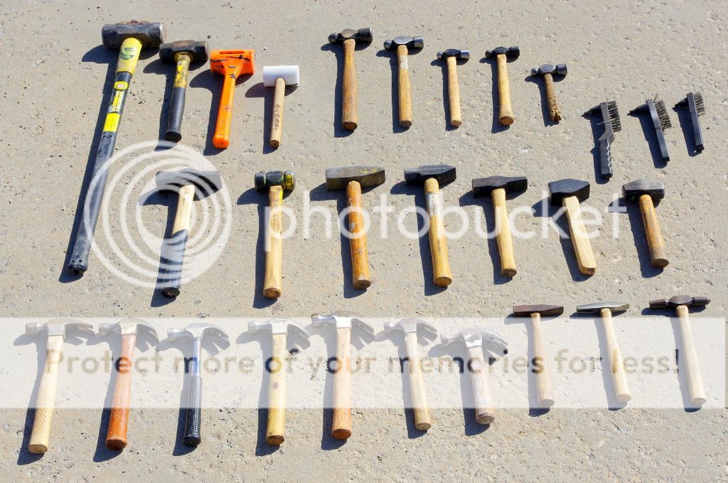

I made 4 more hammers the other day... lol
All rounding hammers in 1.5lbs, 2lbs, 2.75lbs, and 3.5lbs...

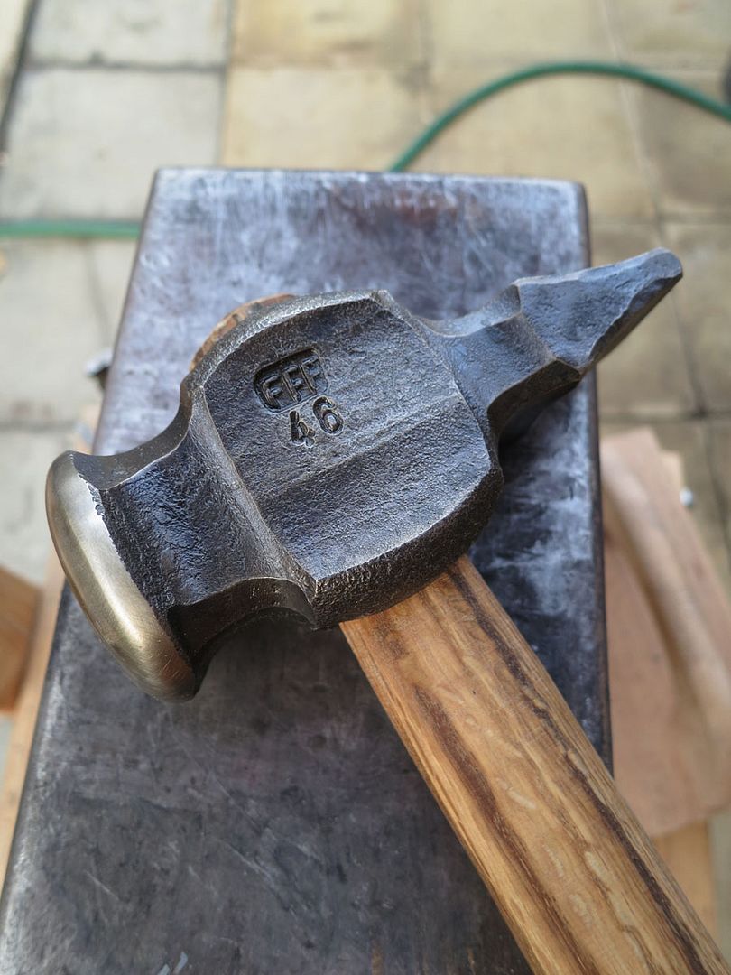

I picked up a couple of hammers from Cergol Tool and Forgeworks.
Love both of them. Haven't been able to do much smithing lately but my new workshop is just about complete. Once that's done I'll be hitting it hard :D

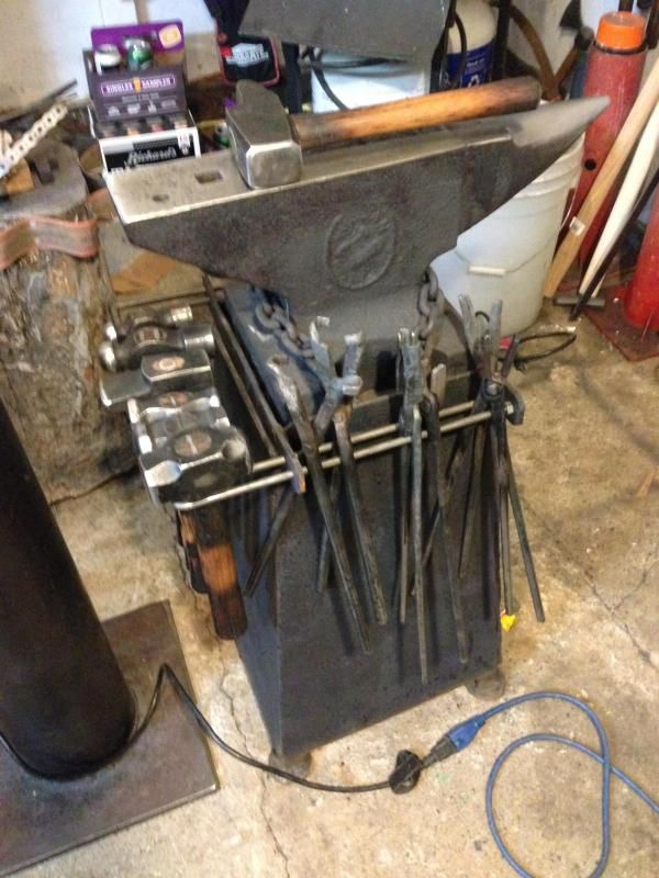

Now why can't I find anvils like that??? I finally broke down and bought a new one, a 330 lb. Refflinghause, expensive, but well worth it and a joy to work on after years on a harbor freight russian cast steel. And made this post anvil, it's a 4x4x12" chunk of 4140 I quenched in super quench. The 5" square tube is filled with sand and the anvil is wedged in place on the sides. Works very well for forming the bevels, though I think I might like a horizontal anvil similar to the Japanese sword smiths use better.

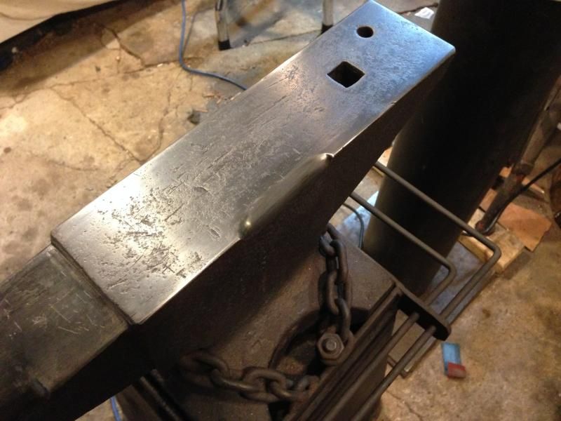

Here's a Peter Wright(I think) 155lb anvil I got for $140. I put up an ad on Craigslist and it really worked out well.
Since these pics I've hit it with a wire wheel brush on the angle grinder and it's cleaned up real nice.
