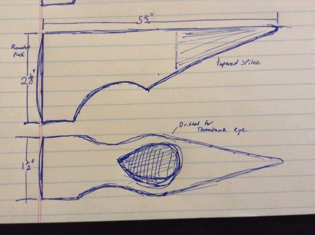

Not to hijack but are there any Canadian smiths forging custom hammers? I've got an idea for something I want.
Here's a poorly drawn sketch to give an idea what I'm thinking about
