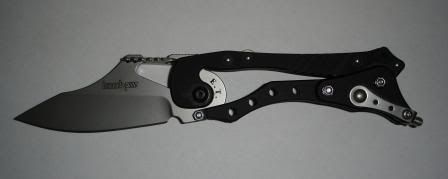

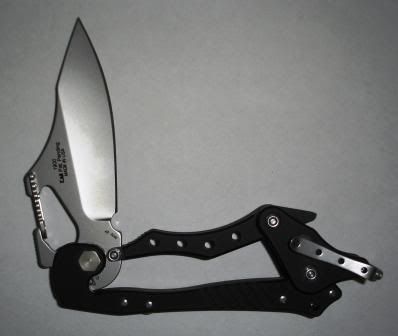

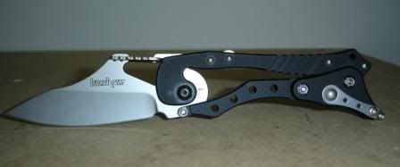

But I've got a question for the other ET owners out there. Is it normal for the blade to get a ding in it where it impacts the spring upon closing?
The obligatory pictures:
Sorry about the bad photos, you get the idea. I tried to get a picture of the ding but my camera couldn't handle the fine focusing.
The E.T. is definitely some fantastic technology. I love mine!
The way the knife is designed, the blade tip should not be contacting the spring at the butt end when closing. The nut-and-bolt assembly that attaches the frame to the bottom of the blade's tang should be nestling into the U-shaped frame cavity under the pivot bolt and stopping the blade before the knife tip reaches that spring...mine's 1/8"+ away from the spring when closed.
If yours is contacting the spring, I'm sorry to hear that...it sounds like a job for Kershaw's excellent customer service.
Ray
Thanks for the info. I see what you mean about the nut hitting the "U-shaped frame cavity." Excellent concept, but it isn't working on mine. I'll contact Kershaw immediately and post the results here.
Just got off the phone with Tiffany at Kershaw. They'll replace the knife under warranty, which I'm grateful for. However, I am saddened that I'll have to go another week or more before playing with it again . . .
