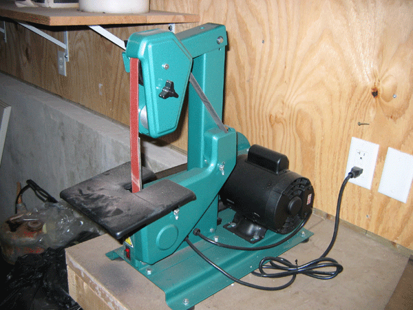

That's what I do too but now I'm starting to use my 2 x 48 grinder and what it would take me an hour to do with the stones takes about 5 minutes with the grinder.:thumbup:

What is the 2 x 48 grinder?

This is a 2" x 48" cheaper than dirt one speed grinder: (less than $100 at F&F IIRC)
And yes, this stuff should make profiling a knife faster than the Sharpmaker alone.(especially the grinder)
