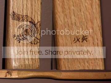

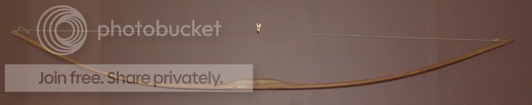

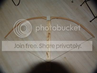

Here's my first:
The lower limb is a little wack, but it was my first shot. It shoots well, has low shock, and is powerful enough to take down anything in the Americas.

CanDo, thats a neat bow. Mine was just a crude stick. Just wanted to see if one could be made quickly.

Thanks dipbait. There's a lot to be said for "green bows", especially in a survival situation. Again, ask the folks on PaleoPlanet about them...
cando-- great looking bow, for a first time... right on...:thumbup: it is definately not easy to do.. i have yet to make a good shooter, i've tried it twice and always seem to end up screwing something up at the last minute....:o i actually have a nice chunk of juniper and walnut, cureing as we speak...
