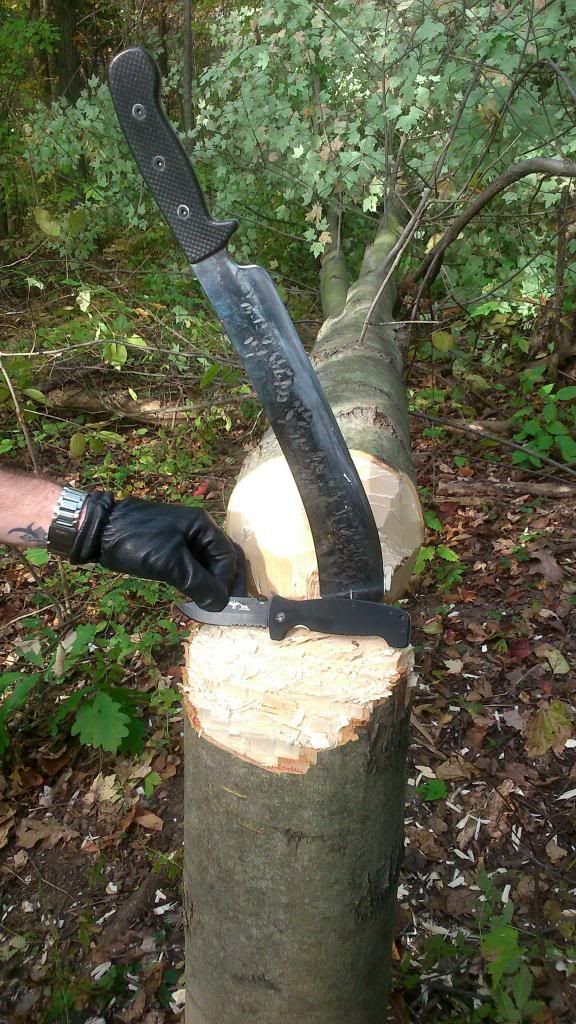

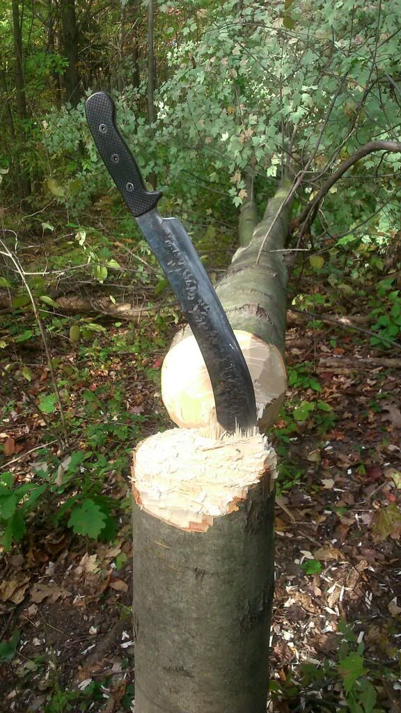

But does it work? You be the judge...

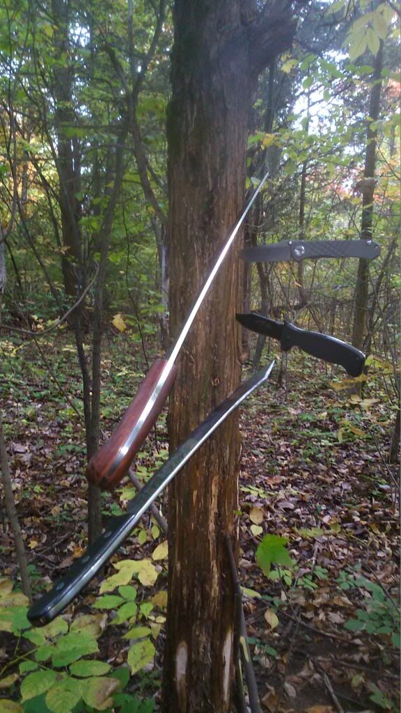

CQC-12 as measuring device (9 inch length):
Group shot posing session:

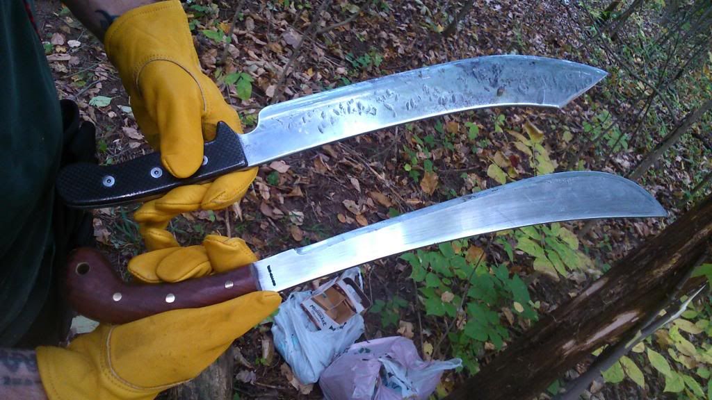

Comparison with Condor Knives Golok:

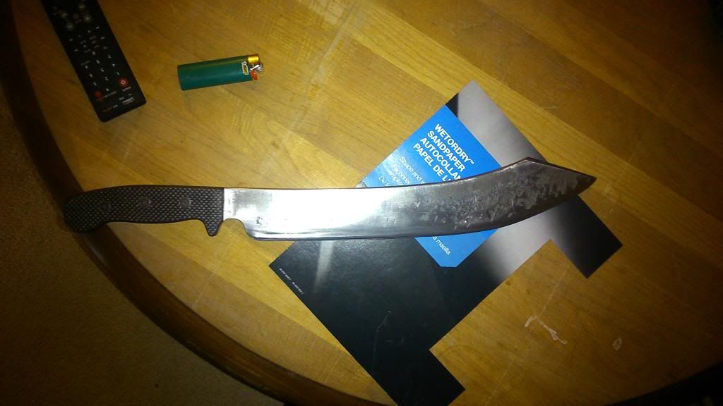

Overall length: 21"
Blade length: 15", with 14" cutting edge
Thickness: 1/4" thick 5160 steel
Handle scales: 3/16" thick lightning strike carbon fiber
Weight: 2.38 pounds
