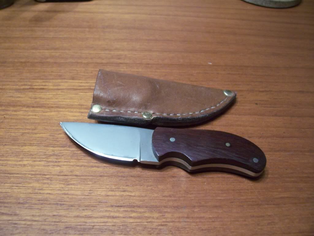

Hey Mike did you do the design from a blueprint of did you just free hand the shape. I don’t know if this a dumb question but can I have an outline of it. I am going to try making my first knife and I really like the design of your knife.
Sure, Warrior, that could be arranged. PM me your snail mail address. I will send you a tracing. If I had a scanner I think there's a high tech way to do it...but I don't got no steenking scanner. :)

I made this several years ago. I really can't recall sources for the materials, but they shouldn't be hard to find. Ground it on a Dremel 1x30 belt/disc sander which is really a toy. The place where I worked had a bandsaw. I traced the outline on the steel stock which I had painted with blue stuff (Dykem) and cut it out. Access to the bandsaw was a real time saver.
Cutting out the outline with a coping saw would have been a real PITA.
If you don't have even a small belt sander or any power tools other than maybe a common hand drill, you can still make a decent stock-removal knife. It just takes patience and determination (qualities lacking in a lot of folks these days).
Get some annealed O-1 stock, paint it with "Prussian Blue" trace and cut out the outline of your knife and then "grind" out the blade bevels with files. It works. Just takes time and elbow grease. I am recommending O-1 because it is the easiest to work with, and makes a pretty good knife. Other tool steels, even when annealed dead soft, are much tougher.
After you get close with the file, start using sand paper, maybe 80-100 grit working down to maybe 220 grit until the knife is "almost" finished. You don't want to get it too "thin" at this point or the heat treating could cause warpage. After heat treat, back to the sand paper (backed up by a hard block) until you get the desired finish. Then attach the handle of choice. This is way over-simplified, and I'm sure Yvsa or someone else who knows metal working better than me can add some tips. (Yvsa has forgotten more metal working than I will ever know.)

Here's a little 3-finger knife. ATS-34 blade and Purple heart handle. 2 stainless and 1 brass pin for chuckles.
Dangit wasn't supposed to be so big.
Sorry!
