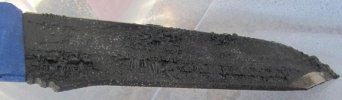

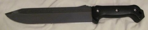

Then I striped the coating from the blade and added stainless steel fasteners. Still working on custom handles to be added later.
I used Jasco brand paint stripper from Lowe's. I did it outside, in the sun, with the air temp about 70degF. Let it set for 30 minutes and scraped most of the coating off. A second, 20 minute session removes the stubborn bits.

Here's the final product. I could only post 5 pics directly in the initial post.
The blade is kinda dark because of the poor lighting but the "natural patina" of the blade is fairly dark on its own. I don't know if the JASCO stripper caused it to be that dark or if the blade was not polished at all after heat treatment, just the rough scale being knocked off.
