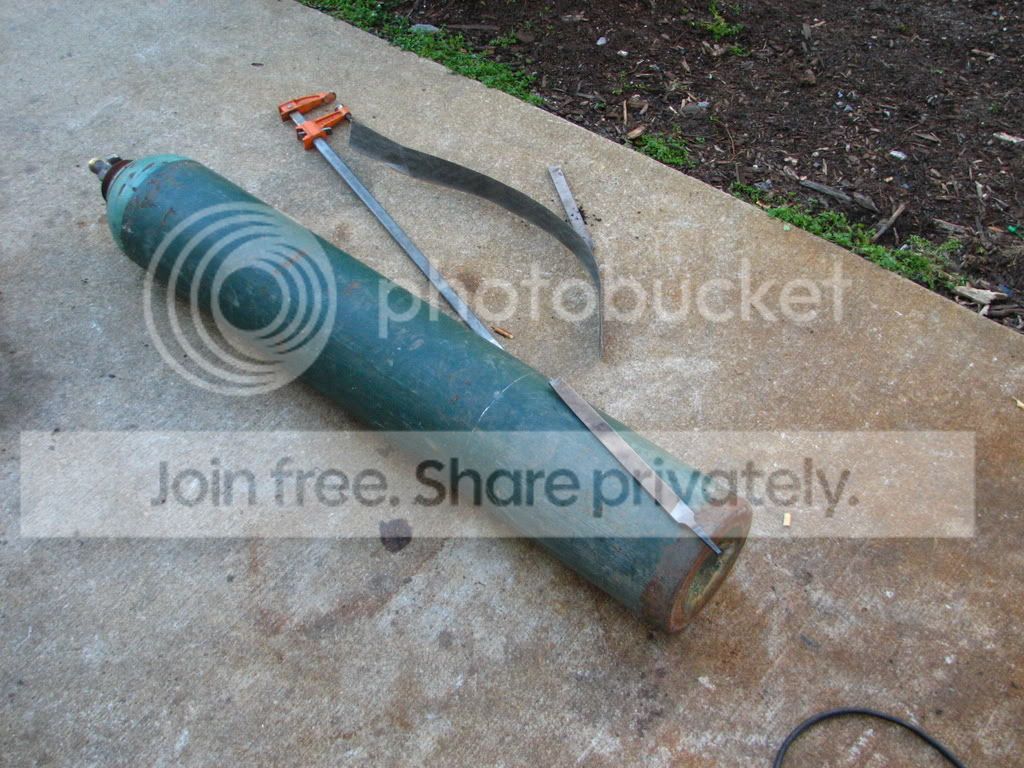

here is a pic of what i have of the tank
i cut off about 12" of the bottom.... so what is left is what i have to work with.
i have a 3/4 burner... and kaowool... so some other people said i should put a burner perpendicular to the tank to get the swirl effect. any idea on the placement?
also can i get away with 1" of kaowool?

Chris, That will work somewhat OK. The trick is to get the whole chamber up to temperature. Cut off the neck end ,and put the burner in the front, at an angle so the flame swirls around toward the back. Put in a piece of 2" pipe so there is no hot spot (put a couple of pieces of fire brick in to keep the pipe centered). Heat the whole forge for ten minutes before putting the blade into the pipe (checking temperature in the pipe if you have a PID or pyrometer). Turn the flame down low to avoid overheating the blade after you put it in. A PID controller will help a lot, but with a long thin chamber, it will not be real accurate. You will have to stick the thermocouple in the pipe with the blade.
With the small diameter, you won't have any choice but to use 1" wool.
Stacy

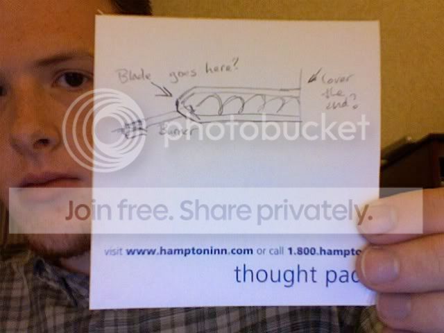

okay stacy... i think i got most of that.... but my mind works in pictures.
so here is a picture of what i think you are saying
guess were i am....
now... i dont understand what you are saying about the pipe. i dont need a real long chamber... but i need at least 18"
are you saying tha ti should put a 2" pipe all the way through? so there is space for the flame between the wall of kaowool and the pipe or what?

You are getting closer.
Put the burner in the side, like the vertical forge,but at about a 30 degree angle toward the back. Put it about 4" from the front. This will make the flame swirl around the chamber. Cut the whole neck off so it is the same on both ends. Put the pipe all the way down the forge. It should be the same length as the forge tube. Use a couple of fire brick pieces to keep the pipe centered, so the flame swirls around the pipe,heating it from the outside. The blade (inside the pipe) will be evenly heated by the hot pipe. This is called a gas oven. The pipe is called a muffle. You can stack fire bricks to block some of the front and back to get a more even heating. A fire brick plug on the back end of the pipe will keep the temperature more even inside the pipe. I have a good bit of the 2", heavy wall, stainless pipe. If you need some, let me know.
Stacy
okay... sounds like a plan!
the pipe should be "suspended" in the middle. but how much hot air should be allowed to escape from the ends... meaing... how well should the ends be blocked? i got the burner placement understood just what the ends should look like is now my problem.
can you explain that a little more for me?
