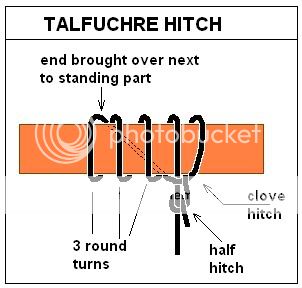

I played around with a couple different things and I came up with the Talfuchre Hitch. Take the end and make 3 round turns, then down behind the spar, over next to the standing part and make a clove hitch, with the working end down (dress the knot so it tightens up). Then half hitch the end to the standing part. Voila, the Talfuchre Hitch. (the three round turns should be touching each other - I left them apart for better visuals).
Basically, it's a knot that's in Ashley with 3 round turns added in.
