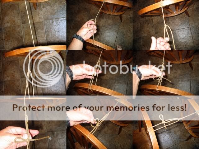

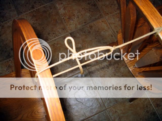

Here is my bastardized version of the trucker's hitch. The best thing about this one is a few quick pulls and all the knots pop out. Very strong too... I used it all the time.
Rick
Left to right...
Actually, Rick, I don't know why you consider it bastardized - looks pretty normal to me.

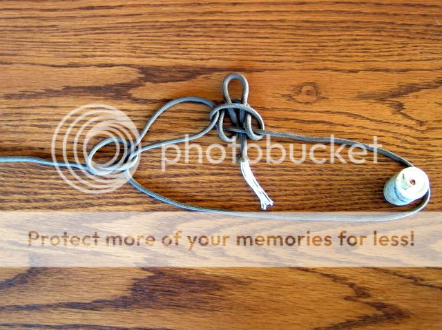

Another interesting take on a Trucker's Hitch (I've seen it called a Hayman's Hitch (?) ). It's basically half a Sheepshank that is toggled.
