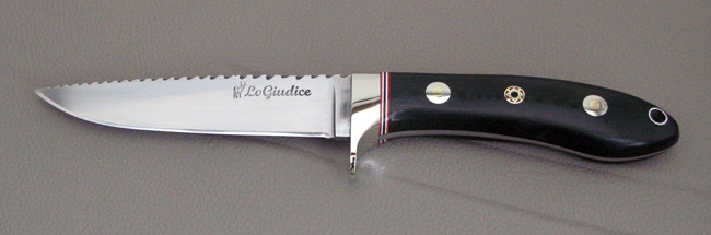

Here's a knife that I made fairly recently that may get close to what they are requesting. Hopefully, this gets your thoughts flowing or helps generate some more input from others?
This blade is 4 inches long.

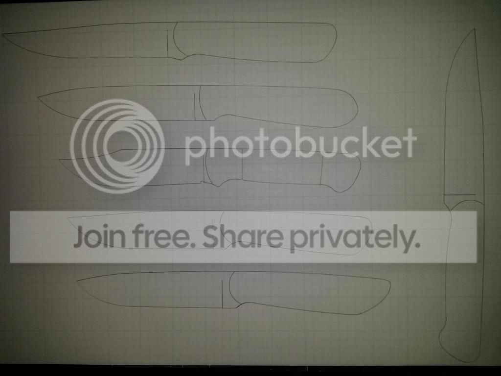

Here are some drawings I made last night, inspired by your query. Let me begin by disclosing that I am not an experienced maker. I am just starting out and realized early on that I had no idea how all the parts of a knife came together. So while my grinder is being built and my work shop put together, I have been drawing knives. I usually do so every night in an effort to better understand proportion and how angles and lines interact with one another. I usually draw a page or three every night and often look to here for inspiration.
So here is a page of ideas trying to keep within your general parameters. The grid on the paper is a 1/4" per little square, 1" for the bolder lined squares. Steel choice would better be left to others to recommend. Same with handle material, how ever while drawing I mostly envision g10, micarta, stabilized wood, or natural wood like African Blackwood or Pau Ferro (specific to a project I have in mind). Plunge line and leading edge of handle scales are drawn just to better help me visualize a finished project. They should be adapted to personal taste, mood, and skill. Much the same reason I rarely include the pin placement. What I draw are really just a general profile. Anyway I hope my interpertion gives you some insight to another's thoughts on the subject. Interested to see what you end up doing.
Please feel free to comment, criticize, or suggest improvements to above drawings. I am here to learn.
