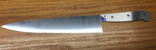

reviving this thread for a reason. For not the first time, I was grinding a rather long chefs knife ..... long and thin, and especially thin in the tip after grinding for a while. Lost concentration on finger placement a couple times......
that is really an aside ..... not for the first time I have found that grinding a long blade - like I was doing today....
is difficult for two reasons: keeping the bevel even is somewhat challenging (but not really that hard) .... but what is really a problem is holding the tip portion of the blade so that you "feel" the bevel without threatening your fingers (either though the above contact with the belt, or with heat ... because the tip is getting progressively thinner. Shorter blades are MUCH easier. How do you people who grind long blades deal with this???? I guess I am thinking specifically about HSC and Pablo, each of whom appear to turn out longer chefs knives on a fairly regular basis....... what do you do to stabilize the work????

I use the tip of my thumb.
Dave - I use the tips of my fingers to support the blade spine underneath. This becomes more critical when the blade gets longer because I can’t really keep it stable just from the handle when I am grinding near the tip. If you use your thumb to press towards the belt - how do you keep the blade stable against vertical motion?
I use thumb and forefinger on the blade not on the spine, when I get to the tip just the thumb. Pressure is applied with the hand on the handle of the blade. The thumb just is directing the pressure.
