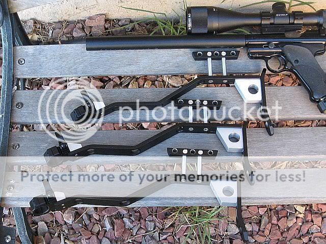

I use it for making gun parts, airgun parts for knifemaking and it performs very well for about a decade.

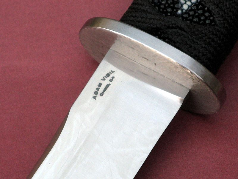

For knifemaking I use it to drill holes, slot guards and sometimes to even up shoulders for the guards

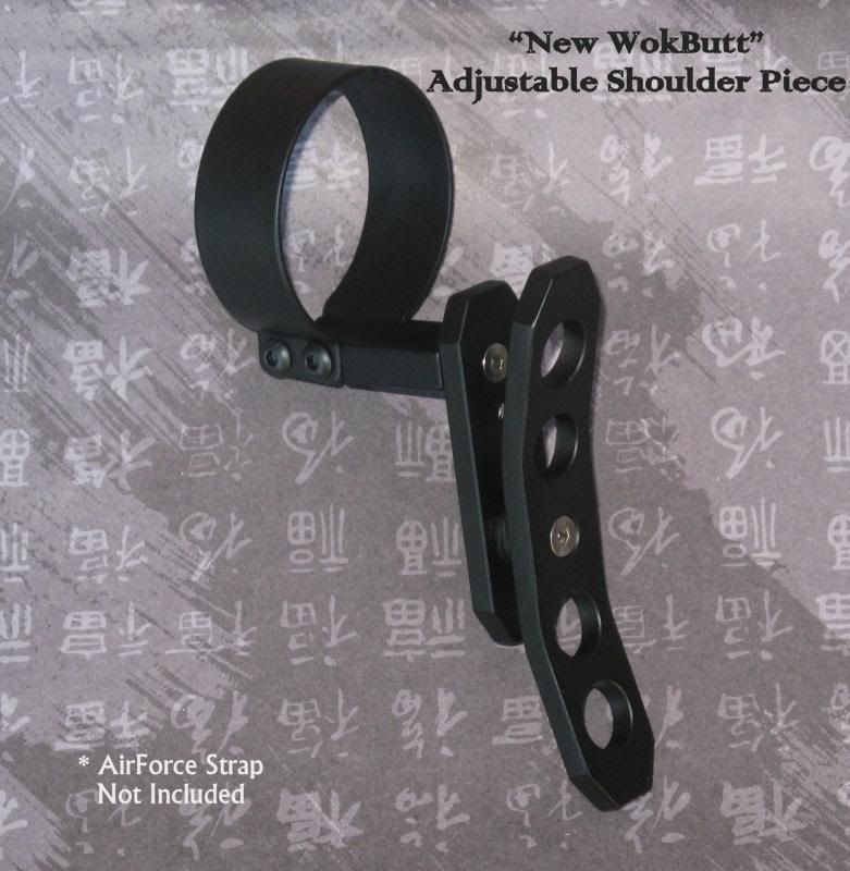

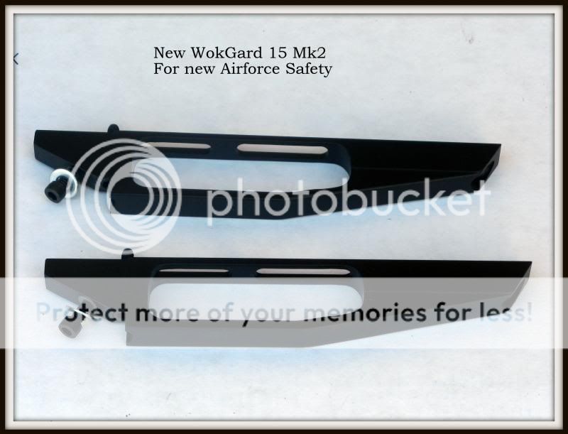

Here are some examples of the stuff I make for airguns on the Mini Mill just to show what it can do.
and of course there is always doing the slot for a guard
