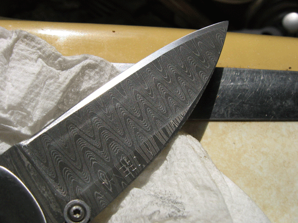

Just got my Edgepro last week and really like it. I mainly bought it for re-profiles though and then I micro-bevel with the Sharpmaker set at 15 degrees. I love the super flat bevels the Edgepro does. Check out the Obenauf Dress Bandit I'm in the middle of re-profiling currently. You can see the last mm or so that I have to go before I'm to the edge with that flat bevel. Plus I've got to even things out towards the pivot which is a problem area for me currently as I'm still not extremely proficient with it. (And the thumbstud is in the way.)

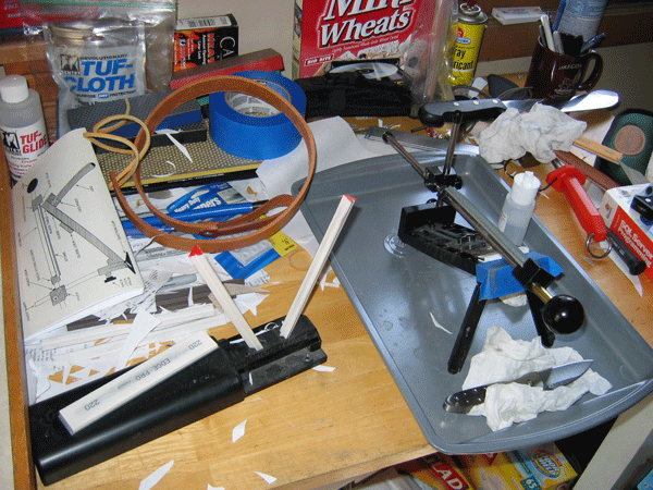

Nice sharpening bench OilMan. Looks like an advanced case of sharpening addiction. (looks just like mine)
Counter clockwise from the top left:
Tuf cloth and a pile of DMT benchstones. Red, blue and black, and a duosharp plate.
Blue painters tape to protect the end of the EdgePro table and to protect blades fron EdgePro scratches.
A leather strop made for hanging use with tie on one end and hand grip on the other.
Just visible under the strop is the EdgePro ceramic sharpening steel and below that a Sharpie marker, a necessity for the SharpMaker and a EdgePro.
Below the Sharpie Marker are the medium SharpMaker rods. Below that the fine rods.
Below that the SharpMaker with ultra-fine rods inserted (as revealed by the red tips). The safety rods are missing!
The EdgePro 220 grit waterstone is laying on top the SharpMaker.
To the right is the EdgePro in a pan to help catch the drips from the water bottle also in the pan.
To the right of that is a sharpening steel I think with an orange handle.
Just right of the orange handle is a Torx screw driver.
To the upper right of the orange handle is the EdgePro 600 grit stone and right of that is the new 800 grit stone.
Did I miss anything?

Nope, that's about it. Besides the junk cabinet of sharpening stuff that doesn't work.:)
