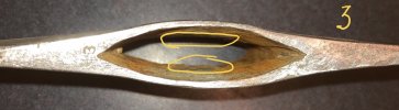

I ended up with this DB, and I’ve done a lot on it so far, but when I started putting on the new haft, I decided to stop and seek the advice of my wise axe colleagues.
#1) does anyone recognize the “W’ (or M?) or the “3” on either side of the eye? The are both on the underside of the bit. There is a “3 1/4” on the side. (See pictures 1 and 2)
#2) the eye is significantly narrower in the middle as a result of using the axe to do some pounding. It is the same on both sides. This is going to make for a tricky hang. It’s more pronounced on one side so as I watch for blade/handle alignment, it’s getting tricky, because the indent on the one side is tilting the bit out of alignment. (See pictures 3 and 4)
#3) as you can see from picture 5, the wall has a thin spot.
#2 and #3 considered, do you think it’s worth completing the rehang? I don’t mind a challenge, but don’t want to waste a nice handle.

That's an Emerson Stevens! Nice db man! The W is the temperer, Watson's, mark. And the 3 is part of the date stamp. Looks to me like possibly 1883. In my opinion it's totally worth it to hang. You'll probably need a super fat wedge due to slimming the haft down enough to get by the hump. I have not bothered to straighten that out before when it's way inside the eye like that. I know some on here have used heat before but I've always just worked around it. And I wouldn't worry about the thin spot in the eye wall either. It'll be plenty strong. That my thoughts on it. Great score! Congrats!

Ya make one. Or you find something that'll work. You could use a cold chisel if the shaft is about the width of the eye. Drive it in, the use a punch to send it out the other side and voila! The dent is gone!

I have opened dented eyes using makeshift drifts. I usually use either an iron workers bull pin or a large cold chisel, sometimes both.
Recall that metal moves easiest where it's hottest. With that in mind I will heat one side, hottest where the dent is deepest, with a MAPP gas torch. I tie a wet rag around the bit just to make sure I don't mess up the temper. I work over the open jaws of my blacksmith vise so the drift can pass thru uninhibited.
After I push out the first side I cool it and then heat the other side. The cold side will resist the drift while the hot side will move. It doesn't always open up perfect but several times it has. The other times it has only been much better.

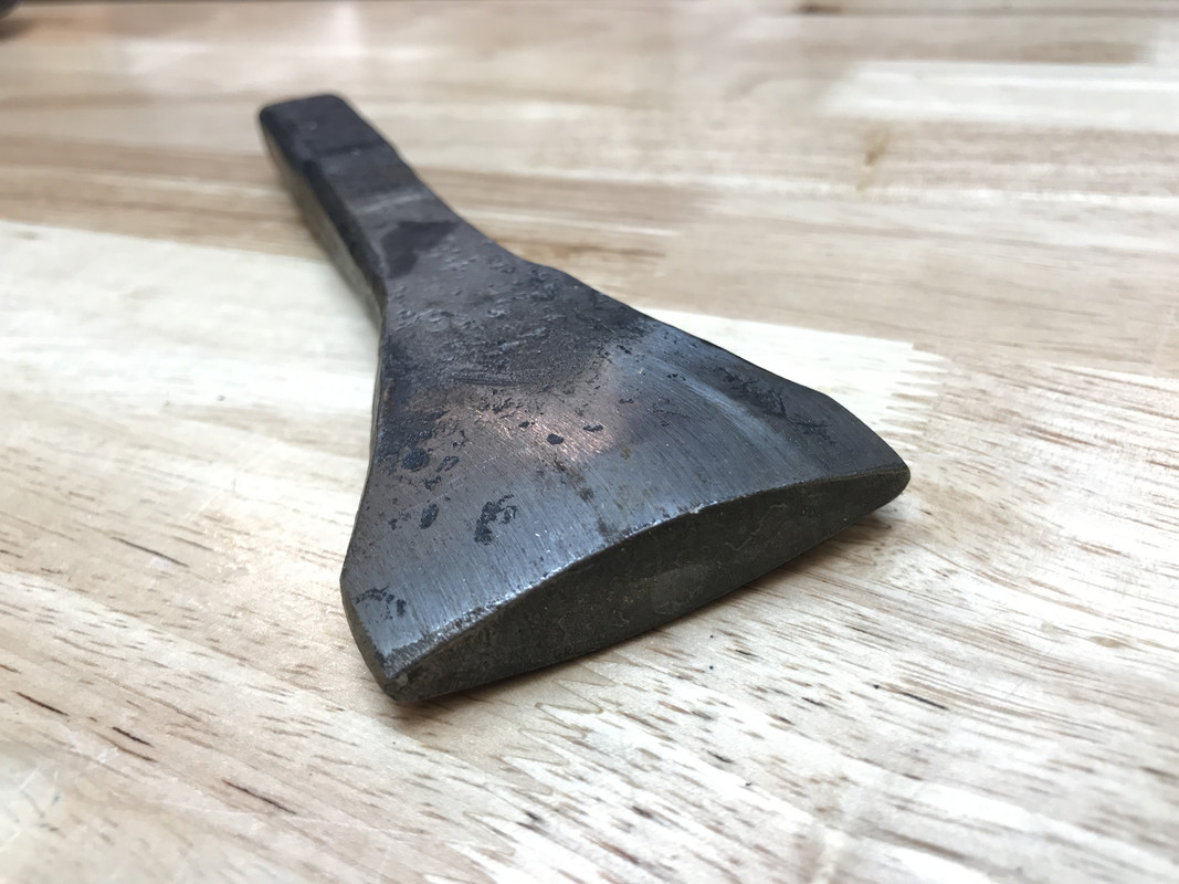

Yessir.I'm afraid Square_peg is absolutely right.The tool in that photo is more of a Punch,and was meant to drive something down before it(like a handle,yes).
A drift will have to be somewhat longer and tapered.
(a common min. taper is 1:7).
A makeshift drift would not be too hard to make.Most DB eyes are probably under 3/4" at the thickest.So 3/4" or maybe even 5/8" thick plate section(one can probably bum something like that at a steel yard,most chunks under one foot are nuisance and scrap).
A 7" angle-grinder + a bit of time would shape it fairly effortlessly to a necessary shape.
A bolster plate of needed curvature can be made out of even thinner plate,a right size hole carved in it,the plate shaped to proper radius,and mounted over the end-grain of a stump with again,a proper recess carved in it.
