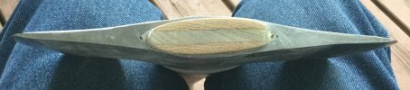

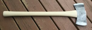

Trickiest hang to date! With the eye in the misshapen hourglass shape it was in, it took a lot of slow, thoughtful work to get this relatively well aligned with a good, tight fit. Considering I was about to throw it out, and then discovered, thanks to Yankee Josh and the rest of you, that it’s an Emerson Stevens Co, I’m proud of the end result. It would sure be nice to determine the date it was made.
807A6FAC-C528-4372-857E-B0709E082A76.jpeg B35FF979-1A01-4DA7-B1CB-6CA02460E294.jpeg 8091B545-028C-4E34-BCC8-3D72254FCD81.jpeg ACD07E0B-253F-4E91-A750-9D31D216C31B.jpeg 63364F76-B6A5-4248-B5DB-16410F888112.jpeg DBEF19C2-00A8-4DDB-ADBE-ED65E50DF83A.jpeg
View attachment 1138987 View attachment 1138986 View attachment 1138985 View attachment 1138984 View attachment 1138983 View attachment 1138982
Well done Curt! It's a good feeling huh! Those misshapen eyes are the toughest ones. They take patience and a ton of on and off. And on and off... Do you live near woods where you can fall a tree? I'll look forward to seeing some pics of you using it. Congrats man! Beautiful hang!
